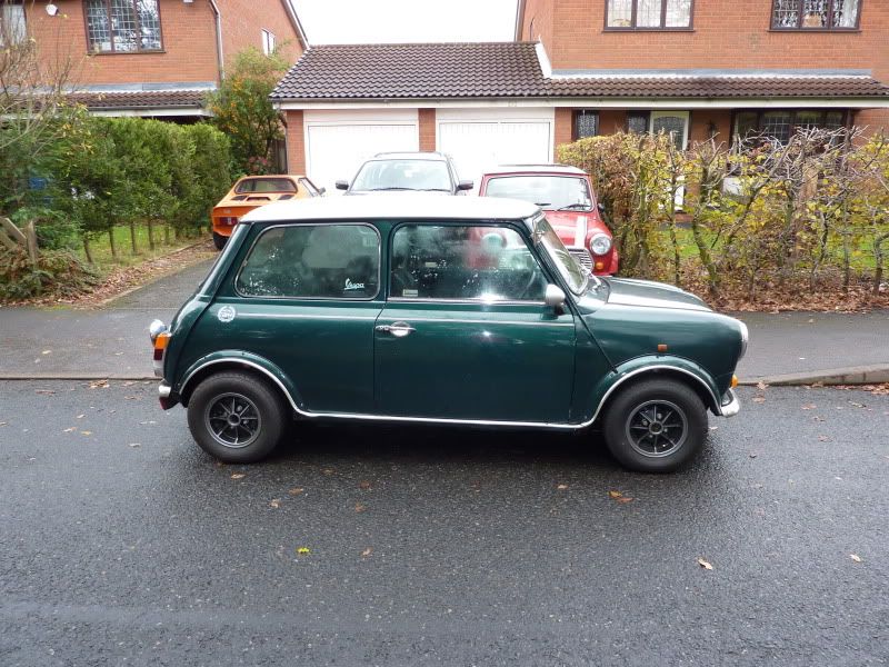

This is what I did when I rebuilt my coper spi.
1) Fitted KYB gas adjust shocks - £106
2) Uprated tie bars - £24
3) Uprated tie bar bushes - £8.15
4) Solid front subframe kit - £41.13
5) Maniflow cat back 1.75" exhaust - £71.50
6) Maniflow LCB - £74.10
7) K&N air filter element to fit air box - £47.00
8) Allow approx £70 for a full service inc. oil, filter, plugs, plug leads, dizzy cap rotor arm and coil + grease up all grease points on your suspension.
That should give you a very nice car to drive and will give you a grin every time you drive it.
I went a bit further and converted the mini to run on 10" wheels. 7.5" disk conversion kits start from approx £250 (all new parts) upwards. Then theres the wheels and tyres.
I managed to pick my wheels up off ebay for £50 and thye tyres i got from a show for £100. My calipers where £60 second hand which i rebuilt with new pistons etc.
I would also recommend replacing the vacuum pipes and fuel trap on the injection system as these do fail over time giving very poor running problems.
Also make sure that the body work is in good condition as this can get very expensive if you can't weld. I did all my own body work as did welding as an apprentice 25 years ago and has come in very handy over the years.
