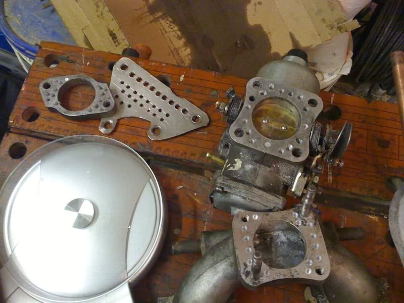

a holy crank pulley of mine, and a gearbox bracket, im still in the process of doing, unless youve seen one of these before you wont realise how much materials already been removed, still loads more to remove, the bitwith the holes in will be completely gone eventually. Next will be the engine mount bracket.

[/quote]
[quote name='samsfern' post='1970035' date='Nov 7 2010, 01:57 PM']a holy crank pulley of mine, and a gearbox bracket, im still in the process of doing, unless youve seen one of these before you wont realise how much materials already been removed, still loads more to remove, the bitwith the holes in will be completely gone eventually. Next will be the engine mount bracket.[/quote]
:thumbsup: CRANK DAMPER???!!! please tell me that isnt going on your engine?
I was thinking that.
#11 samsfern
samsfern
  • 5,243 posts
  • Location: Ringwold, kent
Posted 07 November 2010 - 12:27 PM
going on? It is already on, i know, i had similar thoughts, but still stuck it on. Been fine for a year and still going. It replaced another crank pulley that came apart at the rubber bit. Some a series engines never had dampers fitted anyway, they just had solid pulleys.
Edited by samsfern, 07 November 2010 - 12:57 PM.
#12 mini13
mini13
  • 3,811 posts
Posted 07 November 2010 - 12:28 PM
the mass of the outer part of the crank damper directly affects the rpm that the crank damper works at.
