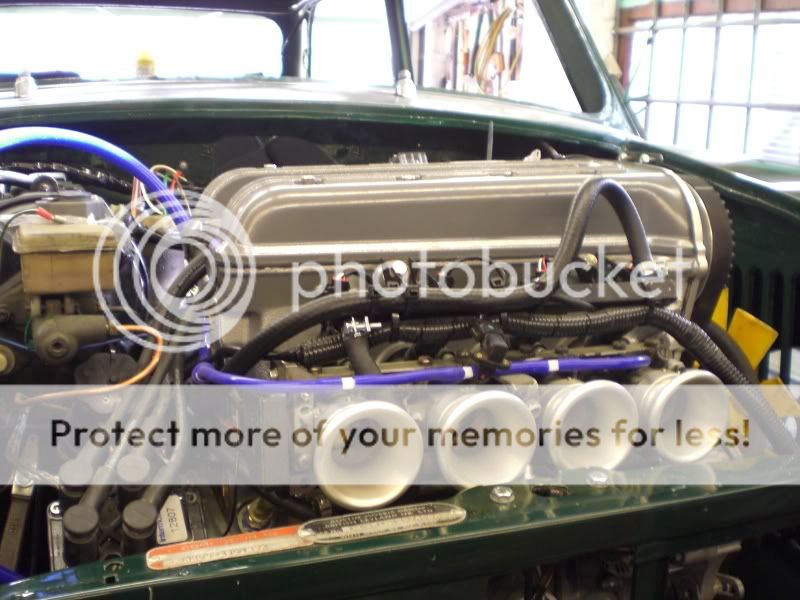

Here's mine that SC did for me and it's not dry decked.
As you can see everything is tight in there
