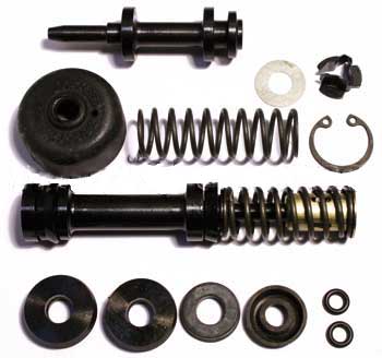

I found this one on MiniMania.com. they want $85.00 for it US
seem reasonable?

£26 + postage to you from Minispares
I'd strip the cylinder first and make sure the bore looks ok.

That repair kit looks quite good, just dont buy the kits from ebay which are just the rubbers.
I bought just the rubbers and had to remove the screw from the centre of the spring/plunger, which included using a screw extractor because it had seized and a trip to A&E to remove the metal shard from my eye. Oh and i was wearing safty glasses at the time but the spring letting go knocked them off my face.
I'd deffo get the kit next time. One other point is to give the master cylinder a quick inspection to check for any roughness inside. I had to give mine a quick ream as a scuff inside was the cause of the seals deteriorating quicker.

I removed the master cylinder and bought the nice kit from MINI Spares. what a nice kit. Everything installed fine. I plan to get it reinstalled over the weekend.
