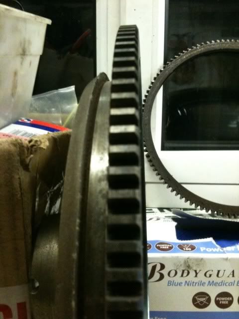

Ok..... like this...?
cheers!

The pre-engaged starter enters from the front of the engine - so any lead-in needs to be on the engine side of the flywheel - the opposite is true for an inertia starter which enters 'from behind' :(

Posted 21 January 2011 - 09:15 PM
Ok so looks like the way im about to put it on... as by the pic is correct. There is a slight angle on both edges, but more so on the right hand side (in the pic)

Yes I think so - but I can't comment on the 129 teeth -I have no idea about that! Strange you are doing this - I think most would be glad to have the inertia starter on the pre-verto.
