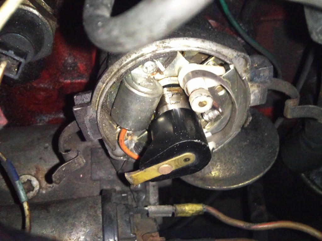

Posted 05 February 2011 - 06:22 PM
this is a picture of my dizzy.
just to confirm this is a 59d and as you can tell it needs servicing haha
#14 stevede
stevede
    As seen on TV
  • 1,164 posts
  • Local Club: None
Posted 05 February 2011 - 06:34 PM
Ethel was suggesting that you take a note of your timing setting before upgrading in case it was optimised (set different to standard) after your rolling road session. That way after the upgrade, you can set the timing back exact as it was when tuned.
If you definately have ballast, then you need to supply the module with a fresh, ignition controlled 12v supply. The feed from the coil on a ballast system is ony 9v. They also advise upgrading the coil to a 12v one. (if you do this, use the same 12v ignition controlled feed and disconnect the existing +'ve wiring from the coil. Accuspark have a FAQ on their web page which gives all the details.
Re my vacuum advance, simple, I forgot to disconnect it when setting the timing with a strobe which gave me a false reading.
As before, if not sure, ask.
