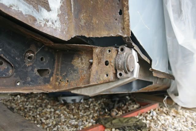

Posted 04 February 2011 - 10:54 PM
these any use??
