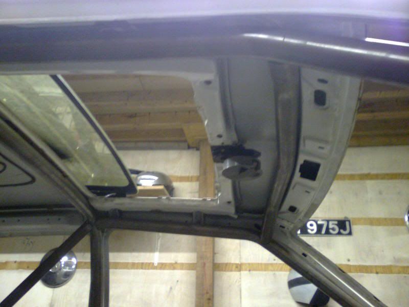

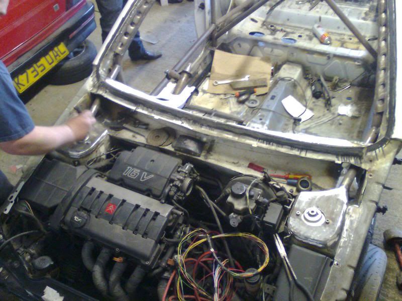

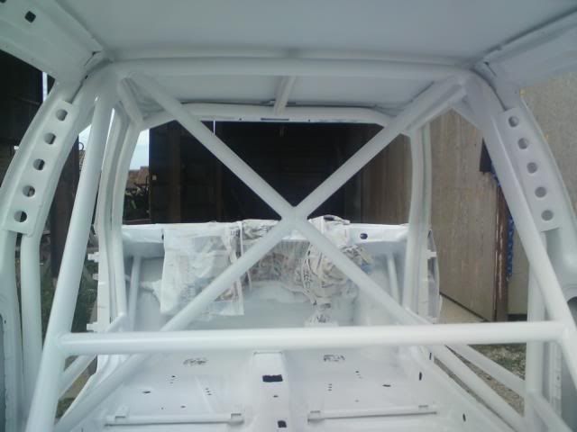

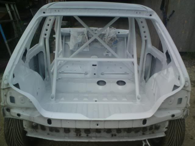

Posted 06 February 2011 - 02:23 PM
a few of the saxo:
a build thread on it: http://s9.zetaboards...7082310/12/#new
cage is from page 6 onwards i think
