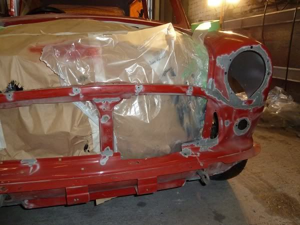

Been a little busy and fell behind slightly (Kids and Holidays springs to mind) anyways I have 4 days to get some paint on before my time is up in the workshop:
Cut out the arches to tuck my 13s under, the jigsaw made light work of the job:
Looked OK but I was unhappy with the flex in the wing so using this:
I made these:
Then using a spot welder got them firmly in place:
After a quick flatten off I was more than happy with the result:
Whilst I was down amongst the arches I took the time to remove the front shock mounts, knowing that the are behind them is prone to rot:
No paint at all / not even primer:
Just caught them in time, so blasted the surface rust out, linished the steel back and treat:
Been quite lucky really as another couple of year on the road and it would have had a hold of yet another MPI.
Tomorrow I plan to get some base coat and laquer in the wheel arches etc, then prep the sportspack arches and doors etc ready for the full monty on Tuesday... All going well..
