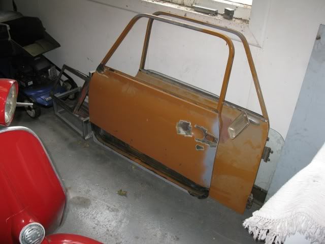

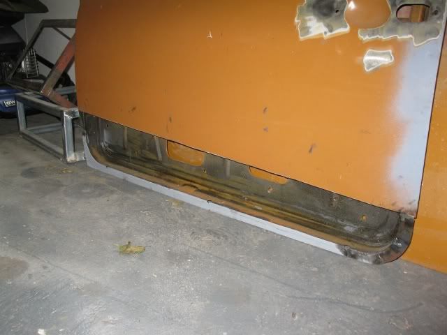

I am looking for some advice on repairing the door skin on my passenger door.
I have already reapired the door frame (I thought the frame repair would be the hard part) but have hit a speed bump for the door skin.
I think I need to give the new steel some shape before I weld it. I am not sure how I can without taking the new steel to a panel beater.
Any advice appreciated.

I wouls have replaced the whole doorskin, would have been a lot easier and quicker than trying to put a patch in.

i'm sure you can buy a door bottom repair panel? i seem to remember having one kickin about in the shed for a while...

If I replace the door skin I assume I spot weld across the top then fold the lip over around the door.
The only reason I ws going to put a patch on was to keep the cost down.

You can buy repair sections that fit the lower part of the skin however you will warp the skin no matter how careful you are so rather than messing around with that then a replacement door skin would be a better approach. If money is tight then stick to the repair section but if you intend keeping your car then replace the skin and use a Heritage skin as they are so much better.
Spot weld the new skin at the frame pillars and then at the top of the skins seam weld the skin to the door frame, the rest is folded round. Use a panel beating hammer and dolly. The folding tool you can buy leaves marks on the folded lip.
If you go the re skin route do paint inside the skin to offer as much protection as possible and once fitted then pump Waxoyl in but make sure your drain holes are clear.

Jesus that's steep, sorry hadn't realised you were in Kiwi land. Plan B, buy the repair section as it will be a lot cheaper, carefully joggle the remaining door skin then once you are happy everything is good tack weld the repair section in place. Each time you do this cool the weld down with a damp cloth or get a section of central heating copper pipe, split it and hammer it flat. Once you have done that then pin it to the back of the weld area and this will then act as a heat soak to help minimize distortion.
Then instead of seam welding pulse weld in sections no longer than an 1" miss and 1" do the same etc. A bit like this, ignore the cut out section but you can see the individual welds or pulses. They are for intent and purposes tack welds but the torch is held on for a little longer to ensure good weld penetration

Once the welding is done then grind back flush, skim with filler and job done. I have done this before and although i did the filling the final product was good enough to keep my missus from complaining.
