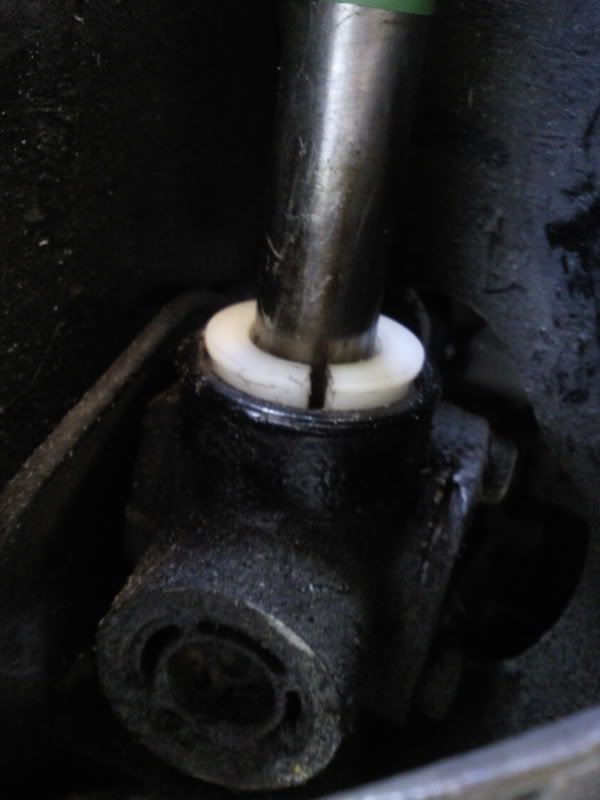

As you can see the limiter is pretty battered after my many attempts of clamping the dam things on! You can also see that that gap isn't quite closed up, however the photos of the ones Kam fitted weren't fully closed either and like I said they were on tight at this point.
So then I thought i'd move the rack to see how much they limit the racks travel and this is wear the real problem comes in. The cable tie hits the outer part of the rack! The only thing actually limiting the racks travel is the cable tie itself. What is this all about, surely its only going to take a few times at full lock for this to snap the cable tie off and allow the limiter to slide up and down the rack - Which KAD say is dangerous and could lock the steering.
Here a pic of what I mean, you can see how the tie is being forced over as it comes into contact with the rack:
I'm going to email KAD about this, because I can't see what i'm doing wrong, or what I could do to avoid this problem.
I just want some second opinions on what i'm doing. I'm doing it right aren't I? Also if there are any other people who've fitted these - Did you experience this problem?

I think the cable ties you get in the pack are quite thin, I wouldn't use any thicker ones, also in your picture where you turn to full lock the limiter should be just tucked inside the housing but only by a few mm, when it is tucked inside, the cable tie outer should not be resting against the casing like yours

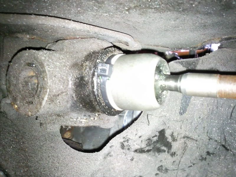

See but the main problem i'm having is that the limiter goes so far into the rack outer that the cable tie will always foul the rack before the limiter actually limits the steering. The following picture shows what I mean. This is how far the limiter goes into my rack before it will limit the steering, and you can see that the groove for the cable tie is half into the outer rack and with the diameter of the limiter and the square end of the cable tie, its too big to fit inside the rack outer so instead fouls it which will eventually just snap the cable tie off.
I've been speaking to KAD - Very quick and helpful replies i'll add.
I've shown them the photos and he said from the photos i've sent him, my rack seems different from any he's seen before?!
They reckon that boiling water is enough to distort the plastic slightly, making it stay spread apart and therefore hard for the cable tie to close up. They say that they use a hot air gun and heat and cool the limiter, whilst bending it apart and after a few times the plastic becomes more forgiving and can be spread open by hand.
They also suggested fitting the limiter without a cable tie. This is because the only reason they stress that the limiter has to be on tight and cannot move is simply to keep it square on the rack. Thats all the cable tie is for, because if the limiter can skew at an angle, it can become wedged in the rack outer and thats where it could become dangerous. So basically if you get these on the rack without distorting them with too much heat, they'll be a fairly tight fit on there own, and so won't be able to skew at an angle.
So my suggestion to KAD was to glue them on. I thought if I degrease the rack and key the surface of the limiter and the rack, then apply some good epoxy glue such as araldite. Then I can clamp the limiter up square and even using a hose clip whilst the glue sets.
KAD say they can't actually tell me to do that since if the glue fails and damage is caused - They could be liable. However he said if I use some good epoxy glue he said he'd be happy to do it on his own can and that the hose clip to keep it on square was a good idea.
So i'm going to give glueing them on a go - Anybody got some suggestions for the best type of glue to use? I was just going to get some araldite on it, but if theres anything better I should consider i'd prefer to get that.
