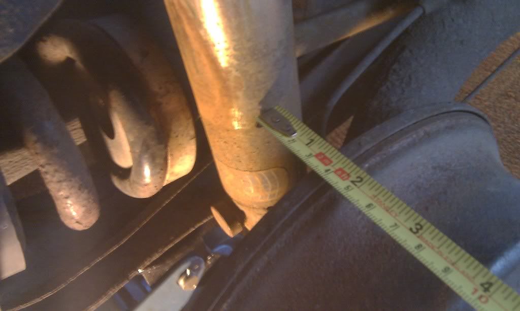

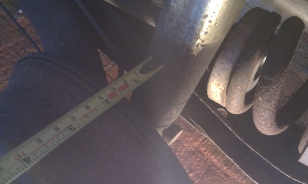

I noticed a problem recently with my passenger side wheel sticking out more than the drivers side at the rear. Today I took the rear wheels off to compare and found the drums to be exactly the same, but the gap between the shock absorber and the back of the drum was inconsistent side to side. Here's some pics to show what I mean:
Nearside
Offside
Doesnt look much, but it's very noticeable with the wheels on. Any idea where this difference comes from? What should I do next?

i would say, its possibly to be a subframe problem... but seeing the point your measuring fromt, the shock absorber tot he back plate.
look and make sure the shocks have the same spacing either side facing the radius arm 1st off
check the measurments elsewhere too. if you can from the drum face to the arch edge.

Cant be a subframe problem for that specific measurement. More likely to be a bent shock/bolt mount or maybe a bent radius arm/mount.

id guess towards radius arm too.... have you had the rear geometry set?

I would say radius arms bent - if you look down on the wheel from above, does it appear to be much further into the arch on one side? Mine is, as one radius arm is slightly bent and it has the effect of making the drum closer to the shock on one side.

Its hard to tell off the pictures but it looks like about 3mm difference ??
That could be a bent backplate, looking at the 2nd picture the backplate does seem to bend towards the shock using the drum as a reference.
Is there any uneven tyre wear ?? Probably not even worth worrying about

That's a thought. It is very noticeable with the wheels on, it looks ridiculous. And can't be good for tracking. The tyres are brand new, but ill check them. Another thing that's wrong is the rear drivers side radius arm is very stiff, I think the larger gaz damper is fouling the inner arch. But its only on that side.
