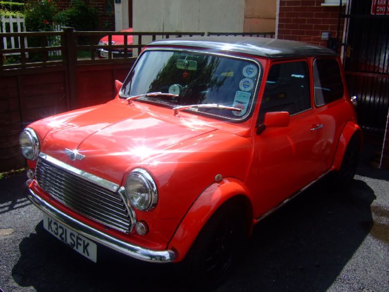

I painted mine with cellulose, flatted with 2000 and 3000 grit, then polished up with Menz Intensive Polish (high cut) and Menz Final Finish (low cut)
