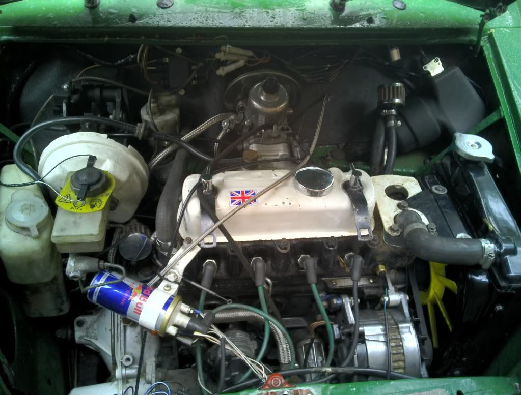

Hello again all, well I've replaced the thermostat with a brand new 88c one and not drilled any holes in it as i have the heater take off (on left side of head as looking into engine bay) drilled out and attached so that it works as a permanent bypass. The engine now appears to run well and gets hot to the touch, the heater even works very well and seems very warm. However, the temp gauge still only goes just above the blue line and will only start creeping towards the center line if stuck in traffic for more than 5 mins. As i have said before i have replaced the sender and it is the correct type. Also the gauge does hit max if i short it out on the engine block so i know thats working fine.
I really cant think of what could be causing the gauge to read where it does, other than the fact i have a 4 core radiator. However, am i right in thinking that surely if the thermostat is brand new and only opens at 88c which it does as i have tested it, then the engine must run at 88c because water cannot flow into the radiator before this temp is reached..?
Any advice or suggestions as to what this might be would be greatly appreciated. Many thanks!
Pic of my engine bay and pipework:
Edited by AndrewUK1990, 05 May 2011 - 04:03 PM.
#9 liirge
liirge
  • 4,097 posts
  • Local Club: EDMC AND MMC
Posted 05 May 2011 - 04:23 PM
Is the Radiator and top hose really warm to touch after a run?
#10 AndrewUK1990
AndrewUK1990
  • 33 posts
  • Location: Leeds & Manchester
Posted 05 May 2011 - 05:54 PM
yes the radiator, hose and thermostat housing get hot after a good run - enough so that you cant touch the housing for too long or it would be painful! The internal heater also blows hot air. I think its probably running about 88c or there abouts, but i just don't understand why the gauge doesn't move further up than the blue mark. As i said, only in traffic on a hot day will it start to creep up towards the middle mark.
by the way i have fitted a 998cc housing on top of the MG metro head so that i could fit the engine steady i had over the thermostat housing. I take it this wont cause any problems as to sealing the hole around the thermostat will it..?
Edited by AndrewUK1990, 05 May 2011 - 06:19 PM.
#11 mike.
mike.
  • 6,176 posts
Posted 05 May 2011 - 08:37 PM
Its got to be a problem with the gauge then, if your heaters getting hot and blowing warm it sounds fine.
Maybe its a problem with the voltage stabiliser, I'm not too sure how they work but have a look at this thread: http://www.theminifo...howtopic=146527
If those are the clocks you've got fitted that might be your solution.
#12 bmcecosse
bmcecosse
  • 9,699 posts
Posted 05 May 2011 - 09:01 PM
It must be the gauge - ONE hole X 1/8" in the stat rim is sufficient.
#13 AndrewUK1990
AndrewUK1990
  • 33 posts
Posted 06 May 2011 - 07:54 AM
Thank-you for the link! That actually seems like this might be my problem! I have those exact dials, but i don't have a voltage stabilizer fitted. I am sure the engine is running at correct temps now anyway, i did a check with a thermometer in the rad and it went to about 85c so im guessing it will be at least 88c where the thermostat is or else it wouldn't open and let the rad get hot.
Well ill fit this to my gauges in a couple of weeks because im busy right now with uni exams. Ill post up the result when ive done it.
Thanks all for the help, very much appreciated!! :thumbsup:
#14 998dave
998dave
    998cc's Of Dave Goodness
  • 4,566 posts
  • Name: Dave
  • Location: Essex
Posted 06 May 2011 - 10:59 AM
Well, hooking up the heater permanently means you are essentially running coolant through a small radiator all the time! not surprise. What i would do is keep your current set-up and NOT drill the thermostat, you should then see it move.
Also is your water temperature gauge electrical or capillary?
You have to have a hole in the thermostat to work as a bypass, but it doesn't have to be very large.
All mini heaters are normally on, (if the switch on your dash is in then it's on), this doesn't work as a thermostat bypass either, it's the wrong way!
Put one hole in the thermostat ring, and get that right, then check your electrical sender and gauge, and the connections.
If it comes to it, measure the coolant temperature by some other means.
Dave
