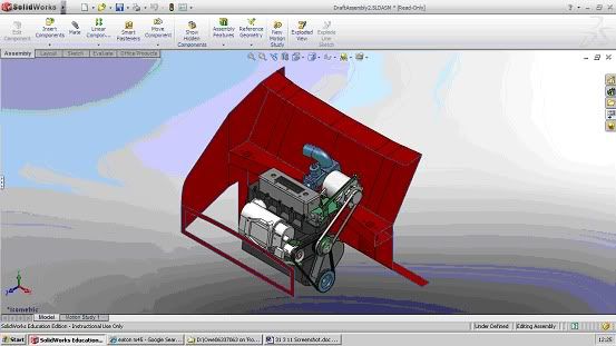

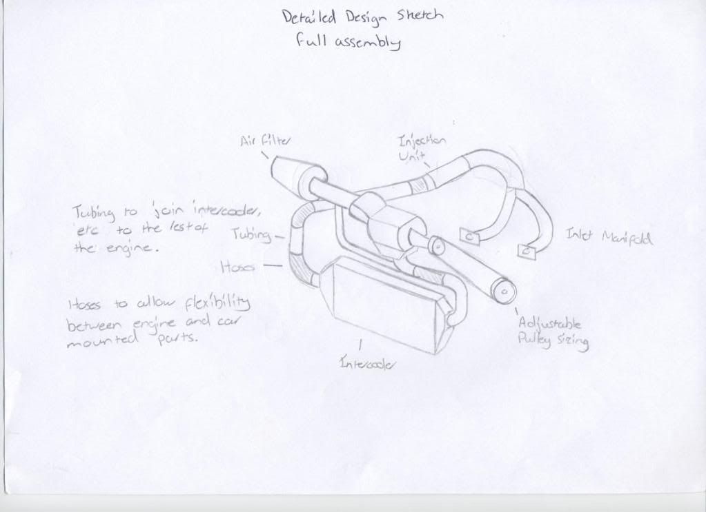

It is a Improved / Blow Through Supercharger Kit for the A-Series and I set myself the challenge at the start of my course in late 2009 to improve these current kits such as Jonspeed and V-Max after I had seen one pouring petrol out of the air filter

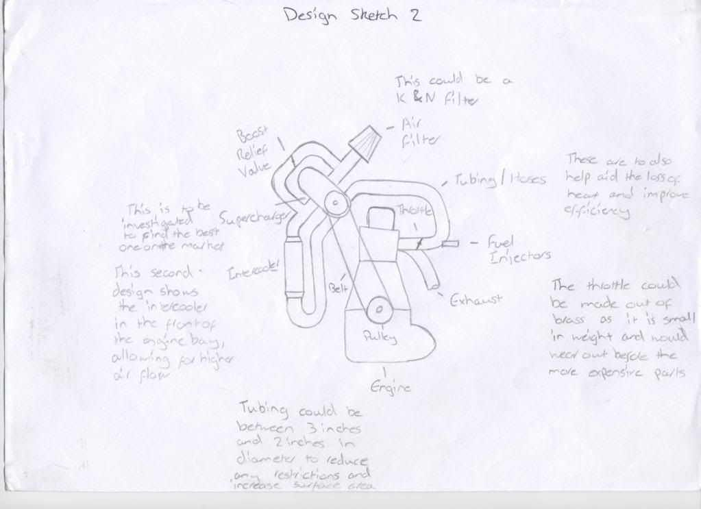

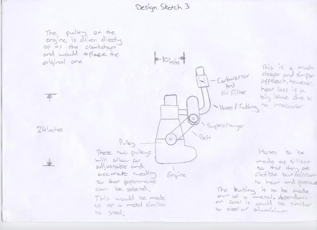

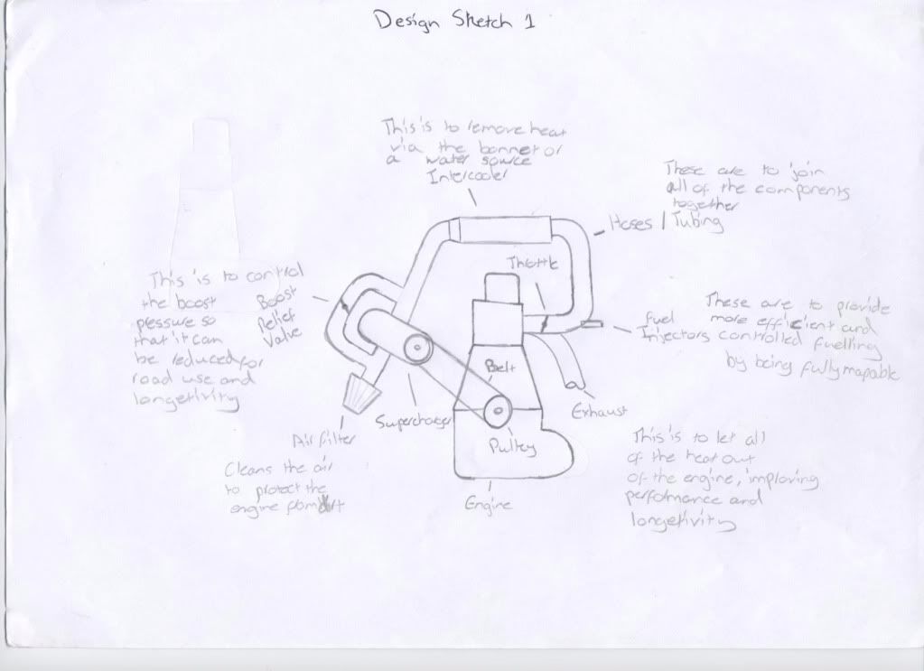

and this is my first design sketch:
