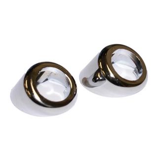

Description of problem (please be as in depth as possible): hi guys bought the classic mini chrome window wiper kit for my mini and havent got a clue how it goes on could any one shed some light on how to fit the window wipers and benzels i didnt take my original window wipers off so dont know how the new ones go on please help

You should have 2 angled pieces which are the wiper bases which pull the wiper mechanism up through the scuttle. The 2 rubber seals go underneath the angled pieces and then 2 nuts need to be screwed onto the wiper spindles to pull them through the angled pieces and hold them there.
The wipers themselves just push into place.

http://images.eselle...edWMBawhite.jpg
hi mate how are the wiper bezels suppose to go on ?? cheers
