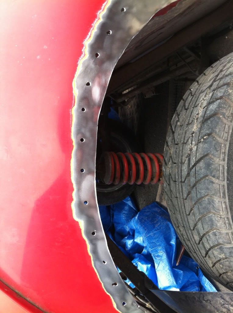

Hi guys - After drilling out the rivets that held on the previous arches and side skirt, I have been left with these nasty holes. Whats the best thing to fill them with? Also, will they pose a problem when it comes to fitting new arches?
Any tips would be great :)

Weld them up.

Not that difficult to do, a few people use copper behind the area that they're welding to help bridge the gap.

I'm new to welding and managed to weld mine up - its not bad to do at all. I build it up gradually, grind down, build up etc.....

Welding them up is the ideal but you can fill these type of holes if for some reason you can't/don't want to weld.
Obviously you don't want anything proud on the surface so you need to bridge the hole on the rear. Clean the surrounding area and then bond a bridging piece over the back of the hole with epoxy (I usually use a small piece of ally or similar). Then fill the ouer surface as you would with any other imperfection.
