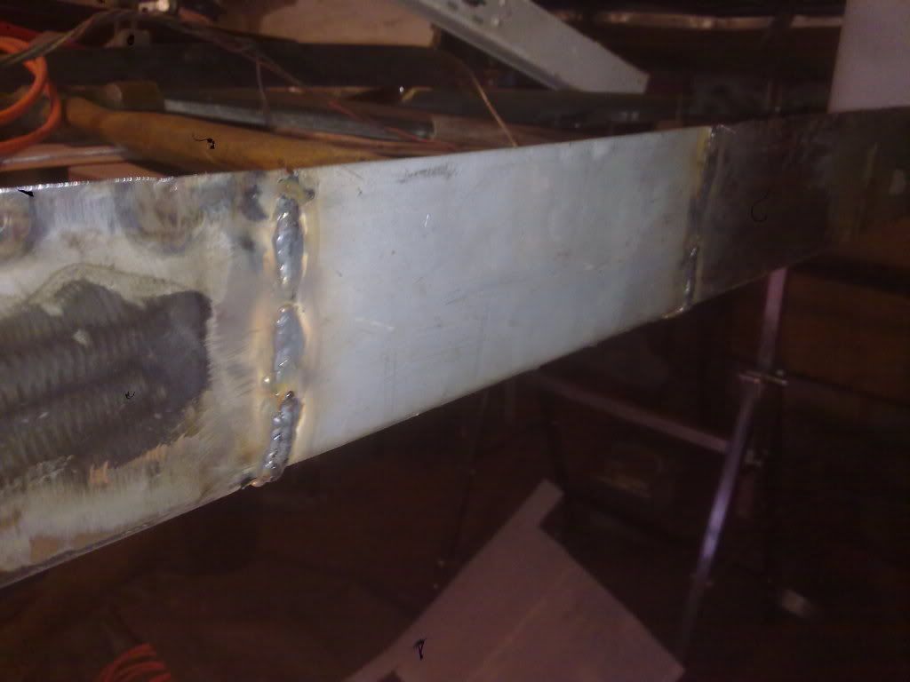

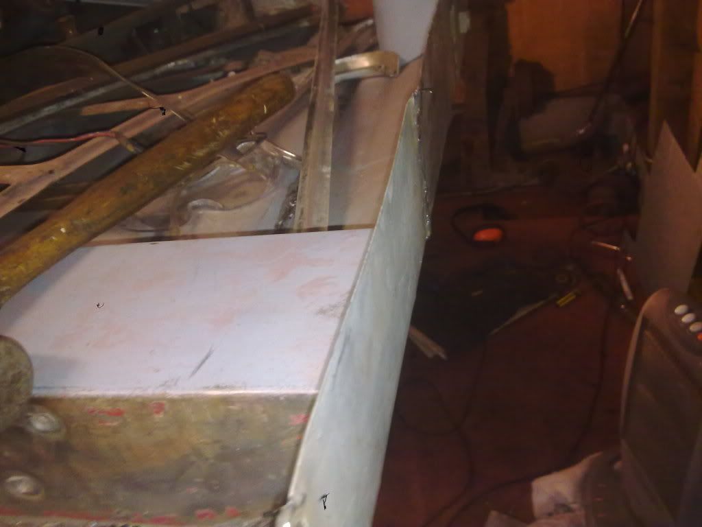

I am replacing the sills and door step on my mini and have removed the jacking point as the floor needed some repair.
I will not need the jacking point when the sills are back on but will i need the replace the bracket that was there? i.e. the part in line with crossmember
I hope this makes sense!
This is how it is looking at the minute
Cheers for the help
Nathan

Ok trying not to sound like a hypocrite here i deleted the jacking points from Project Erm but in hindsight i will now need to carry a trolley jack to lift him up. Whereas in Project Paddy i am replacing the jacking points with new ones to circumvent that issue.
Then as quite rightly pointed out there is also a strength issue as the jacking point is integrated into the outer sill via spot welds and where it ties into the inner sill at the end of the cross member so forming part of the structure.
Erm is only going to be used as a show car whereas Paddy will be a road car. All of the new structure i have fitted will be totally rust proofed and waxoyled plus sealed to prevent water ingress. I wish i had fitted the jacking points on Erm and as had previously been discussed there is the strength issue as well.

I'm not convinced that they add that much, the clubman estate didn't have them fitted. I can only assume that the same applies to the van and pick up as well.
I wouldn't be too concerned about removing them, they are a bit of a rust trap.

Again thats another rust trap. My understanding of them is that they were there for moving the shells around. I don't see how that little bit can provide enough extra reinforcement to warrent replacing it once its rotted out.
On just about every car I've done both of these bits have rotted and then taken the inner sill with them.
I don't usually bother replacing them, if you use genuine outer sills then thats gonna be strong enough.
On the posters car it looks like he's made a nice job of the repair and I'd be very happy with that.
