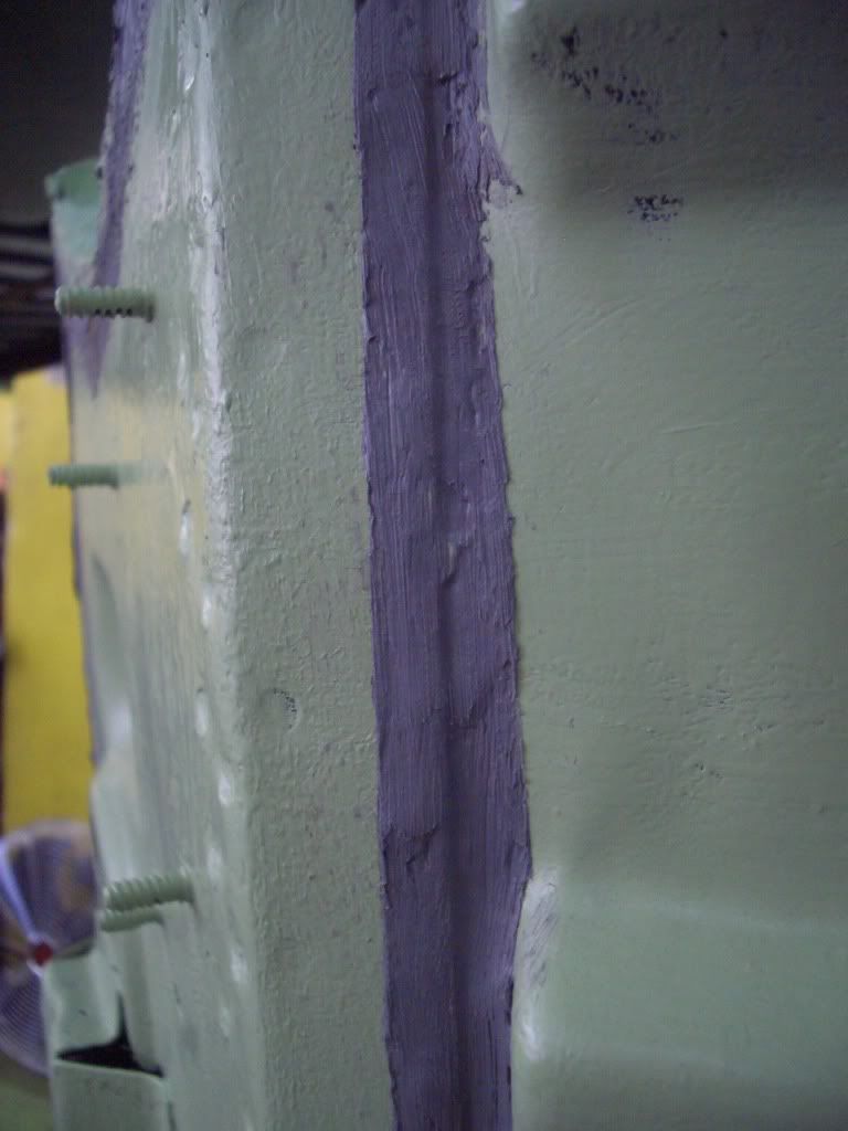

Hi everyone I'm in the middle of sealing the seams underneath a brand new Mini shell and I've got a question I'm wondering.
As we all know there are six sill vents on each side of the Mini. Is it wrong, useless, or is it a good idea to seal these seam vents with brushable seam sealer? Also, what are the sill vents really for? What I want to do is to stop water from entering the sill from the vents. But then I wonder if I'm actually blocking the moisture from ventilating the vents.
I am doing this...
To these...
Much help is appreciated!

No, bad idea, standing water is more of a rust trap then open sills, if condensation / leakage from the rain / etc can't get out then it's going to start rusting faster as it pools in your sills.

Condensation is where it comes from.
There is access to the sills from inside the rear bins in a mini as well.
All you need to do is get a waxoyl tin and the extension probe attachment, then you can fill the sills with waxoyl through the rear bin access and also, you can undo the bottom seatbelt mounting and fill them there too.

Yes, condensation, have you ever gotten into a car with the windows all fogged up?
Well the metal is the same way with a temperature difference inside and out the water will condense on the metal and drip.. More or less like sweat.
If you could build the car in a completely dry environment and seal the sills, the area at the base of the window posts, up in the cantrails, and everywhere else the box section is open to so it was an air tight void, then yes they could be sealed as there would be no way for moisture to get in there. But unfortunately it's not that perfect of a world.. and vents in doors and bodies etc are there to help prolong the life of our cars.
Instead of sealing them up, a better way would be a regular scheduled maintenence of checking to make sure all the drains are clear and free of mud or leaves or other gunk so the liquids could easily and quickly leave the area.
