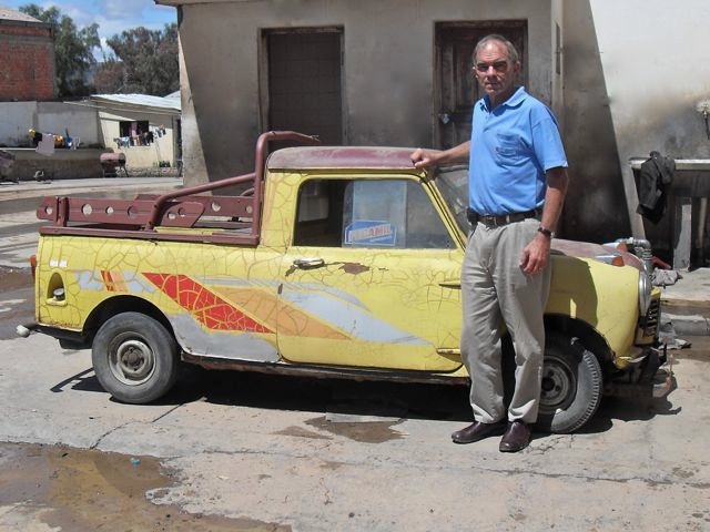

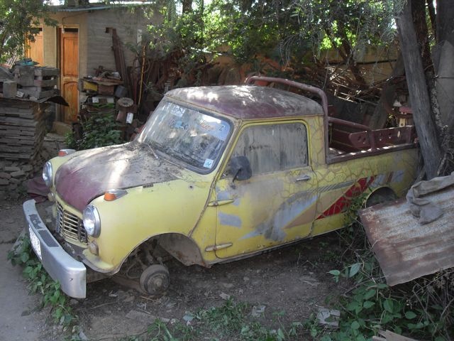

Here is my pickup as I bought it.
Project is underway. Here is one of the first pictures after I bought it. I let him keep his bumper. I didn't think about selling it as scrap.
I haven't had a lot of time to play with it because of business, and because I also ended up buying a Renault Ondine. Check my site for more details and the things that keep me from making this a top priority.

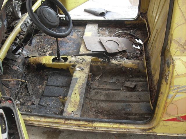

here is the inside

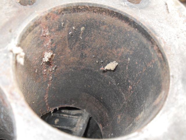

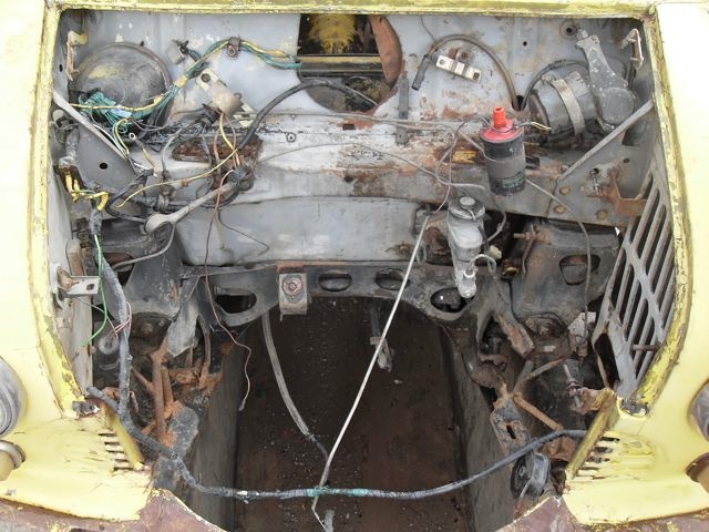

The original engine is pretty much useless. I've ordered a 1275cc from Chile. Just having trouble getting it here.

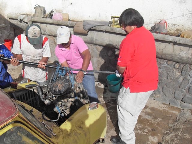

Pulled the Suzuki engine out with my environmentally friendly hoist.

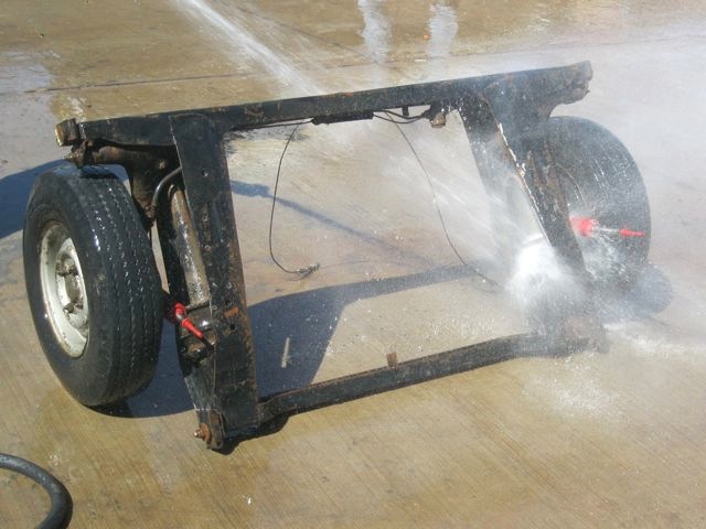

and saw how badly cut up the sub frame is (one is also coming from Chile)

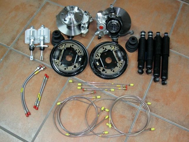

New brakes, wheels, steering, dash and much more has come from the UK

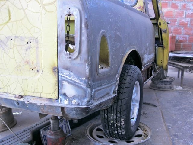

After patching the rear corner, it was time to measure for the fender flares
A little more patching

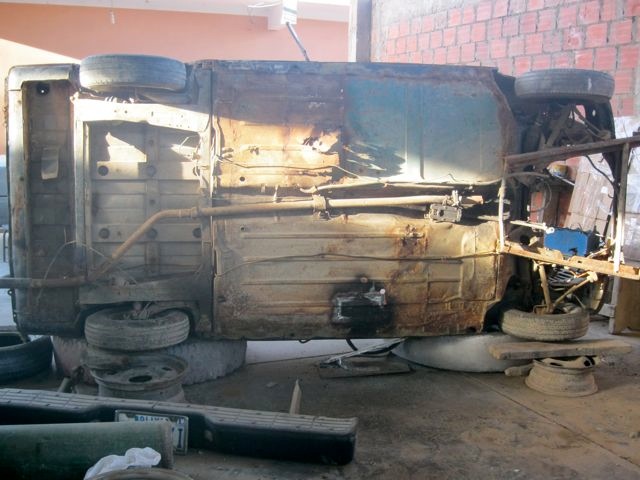

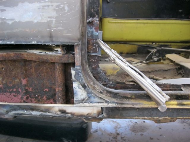

Rolled it over to pull the rear sub-frame to clean and paint, and start replacing the floor with panels from a donor Toyota minivan.
A 15 hp water hose will get it ready to sandblast

So I'll have my 1300cc engine, automatic trans, AC, roll-up windows, etc. I'll sell the 8" brakes and put on the Cooper-S discs I bought earlier to keep the 10" wheels I bought.

I cleaned up and painted the subframe and polished the alternator. When I get back in 3 weeks I'll pull the engine apart to see what I need to order and clean it up.
I had polished up the trumpets for the rear, but since the front came with adjusta-rides, I ordered a set for the back. Posted Image Posted Image Posted Image Posted Image Posted Image Posted Image Posted Image Posted Image Posted Image
Posted Image Posted Image Posted Image Posted Image Posted Image Posted Image Posted Image Posted Image Posted Image Posted Image Posted Image Posted Image Posted Image Posted Image Posted Image Posted Image Posted Image Posted Image

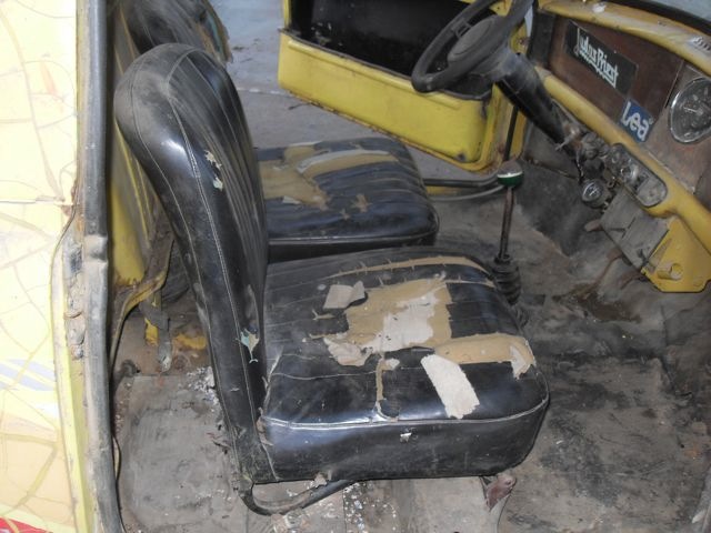

The wooden seats are long gone. Trapped a lot of water and caused a lot of rust.
