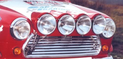

I have a special tuning rover mini lamp pod, I need a way to secure it to my carbon fibre bonnet but I need it to be able to quickly remove it at service.

At work we just have anchor nuts rivvited to the bonnet, one in each corner and bolt it down.... and at the front, these http://www.demon-twe...rs/1599/0/22796

I did miss out the fact it was on a Fiesta R2, but the theorys the same :S id assume... connector wise for the fiesta theres a long tail on the loom to pod, theres sticky tip tie brackets on the bonnet underside so you fasten to wire upto that, upto what ever corner you have the connecter in, just any decent waterproof connecter will do i spose.
I havent got pics either as like i said, its a customers car, the demon tweeks link above should be all you need to connect the steady bars to the pod/body, the anchor nuts are quite self explanatory and we just use alloy bolts, countersunk washers and bolts because they look nice
