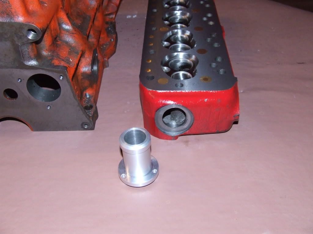

Hi guys can someone clear something up for me about dry decking.
I understand what it is but what I don't understand is where does the pipe connect to after it has left the block? Which part of the head does it connect to?

You have to mill a port into the head, there is no point to connect it to as standard.

Can it go into the heater outlet on the head?

No you need a nice big port on the side of the head.
Picture stolen from Turbo Minis.
Edited by Tupers, 19 August 2012 - 02:57 PM.

yeah, the heater outlet wouldnt flow enough.
