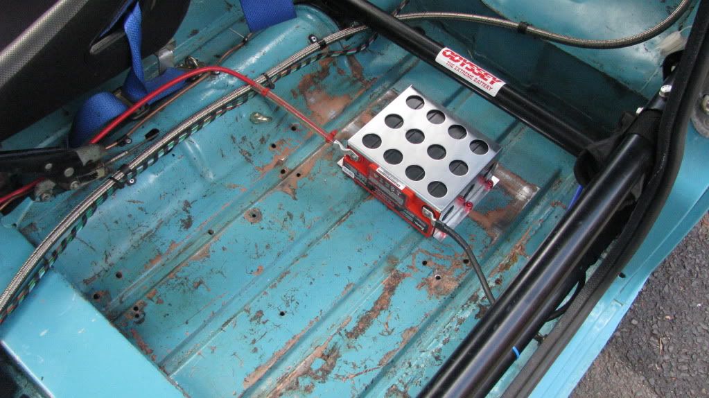

how about a race battery?? odyssey batteries do them and i know that they are vary small, almost half the width of a mini battery box. :)

Sadly the 038 is about 3cm to wide otherwise I'd be laughing. With some minor modification I can get a Varta B16 to fit and that's quite cheap (about £50) - those race batteries are an obscene price!! :X
