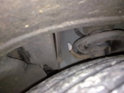

Well pulling out of the drive and BANG, massive noise and the car just slumps to one side, i didnt think it was a puncture because i knew there was a rumour that fiesta springs snap at the front so getting out and checking i could see it was clearly the suspension as it was no long on the mount haha.

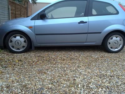

Cant really see the difference but the front has sunk
YES she is on gravel and i cant move her because thats running the risk of piercing the tyre with the broken spring

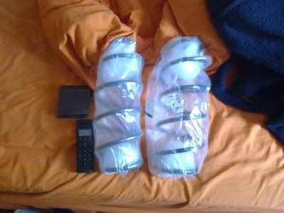

Reckon these would fit my mini? :P
£143 smackers for them, thats like a full set of shocks or coils for a mini :(

This happened to me on a peugeot 406. The car spring broke during the night (was fine day before) got to it in the morning and the car wouldn't move because the broken spring had jammed the wheel! Replaced both front ones just to be safe =]
143 quid for two springs! Are they genuine ford ones or something?
