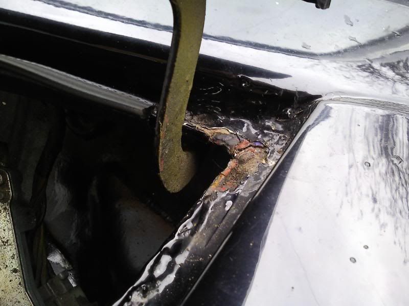

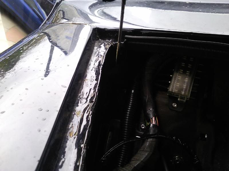

Its not hard to see why the water can get past, as the drip tray on my car isn't great and by the looks of things has been fibreglassed/seam sealered or something in the past and its ended up not having much of an edge to it anymore and also some bits looked to have been chipped/damaged as well. Not sure how well you can see in the photos but heres a couple:
You can see my EDIS unit situated directly below where water would overflow - This leak slipped my mind when I decided to mount it there >_<

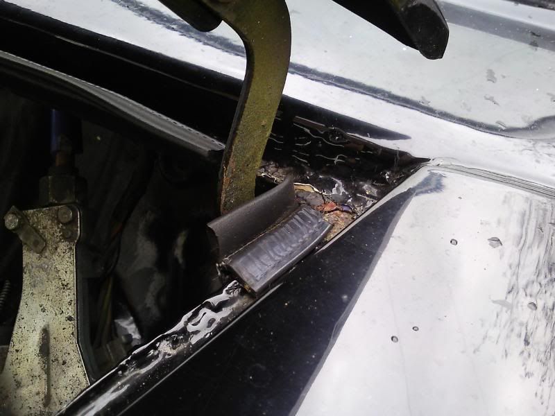

The other side had an obvious point of entry for water, so I tried to seal it with an off cut of the scuttle seal like so:
However when pushing this on, a big chunk of whatever the lip of the drip tray was made out of broke off resulting in this:
Which as you can imagine, even with my little bit of seal in place lets water pour in.
