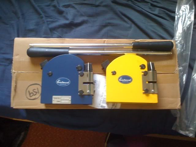

I picked these up off ebay for some of the work I have left to do on my estate. I managed to get them for half the RRP so I'm well chuffed.
This is what they're used for. Clicky

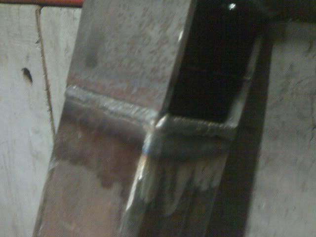

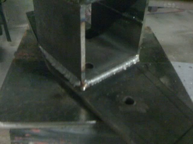

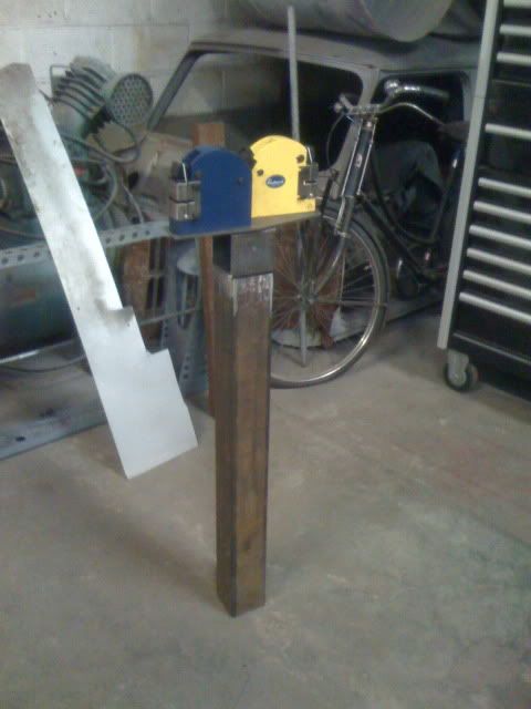

I started making a stand for the shrinker stretchers today. The main upright is 90MM box section with another piece turned 90 degrees at the top so I can get to the mounting bolts and a 5MM thick plate on top. Tomorrow I need to make some legs from rectangular tube that will be welded onto each side of the upright creating a X to keep it stable.
I managed to get some pretty decent welds although it's not to hard with material this thick.

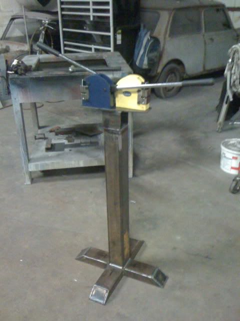

I cracked on and finished off the stand this evening and I'm rather pleased with the result.

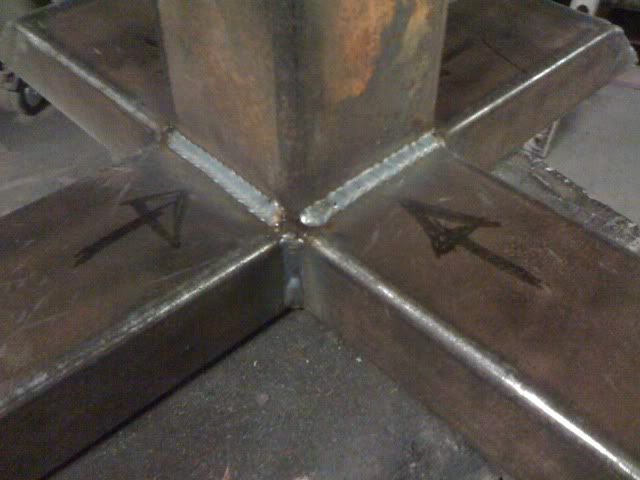

I started out with the feet using some rectangular box section. I decided to slash cut the ends and weld in a plate to make them look a little cleaner.
Once they where all welded I stood the main beam up and arranged the feet around it before tacking them in place. Once I was happy with their position I lifted it onto the bench and welded them fully.
Now the real money shot with the machines bolted up. All in it weights 29KG, not as much as I thought it would but still quite a bit.

Thanks Ross there's a few welds on it that I'm not too pleased with but for the most part they're clean and strong. I'm not sure what colour I want to paint it yet, I've been thinking about a nice bright sliver?

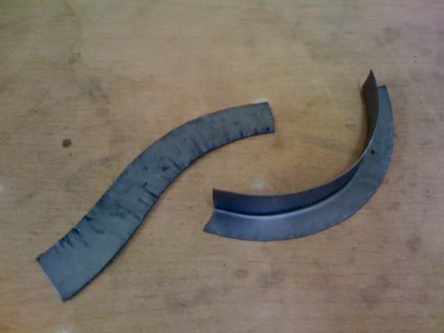

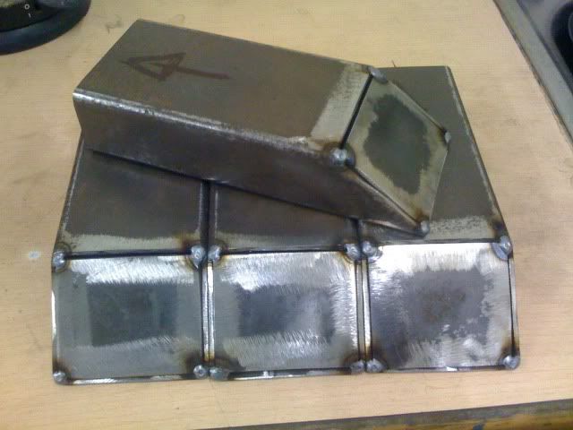

I did a little playing with the machines after I got them all bolted up and I'm very impressed with what it's capable of. The sections bellow are both 1MM mild steel and started out at about 6" long.
