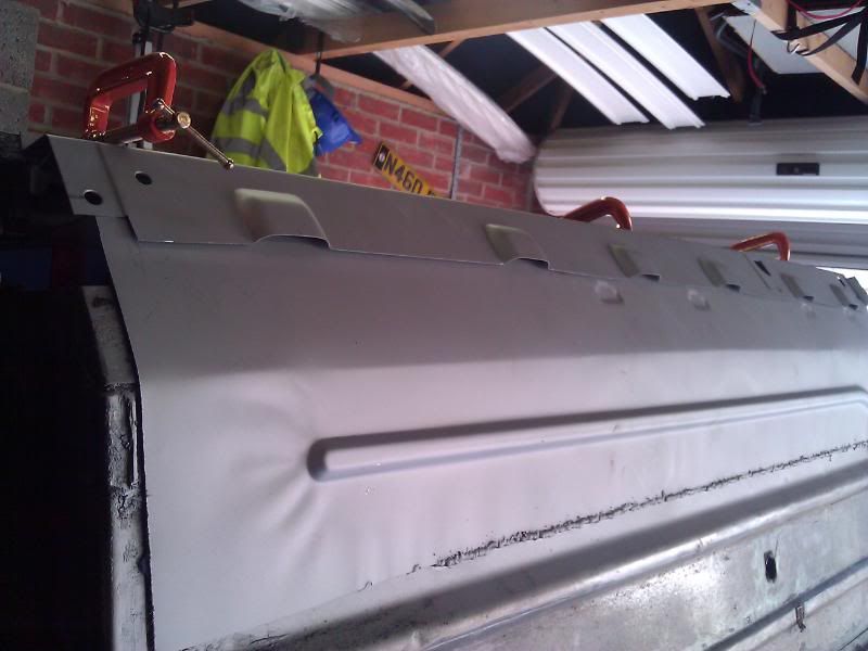

Whats the best way of attaching the outer sills. I was thinking of seam welding underneath and cleaning the lip up on the door sill and possibly hiring a spot welder to do this top seam? Any thourghts would be appreciated.
Can i grind this back to make it flat / neater - treat the rust, etch prime and then spot weld thinking of hiring one for the week (£80)
any help appreciated
Cheers Kev

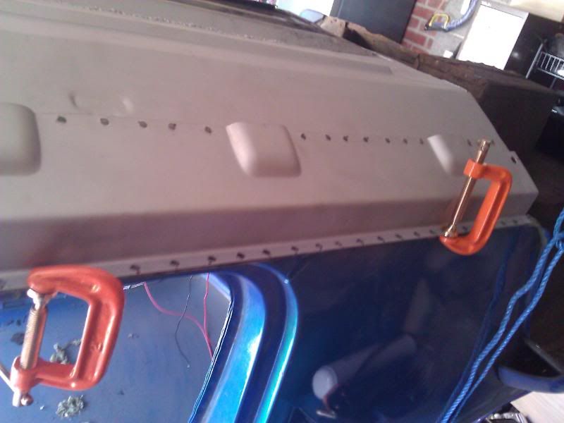

I use a hole punch like this and put a hole into the sill every 15MM and hold it to the car with mole grips and weld into the holes in a circular motion.

Thanks for that looks a pretty neat job.

Its the first time i have used a welder, i have it on the lowest setting as it was putting holes in the replacement panels, i have tested it with a hammer lol. Think i will grind it back and drill some holes and plug weld also. I have dropped the wire size down to .6 and started using gas for the internal weld and it seems a lot better. Using a Clarke 100en turbo on max and setting 1 speed about 6. If anybody lives near Toronto - Co Durham and wants to give me some welding lesons i would appreciate it

We've been doing them as shown in my photos for nearly 30 years and never had an issue when it came to MOT time.

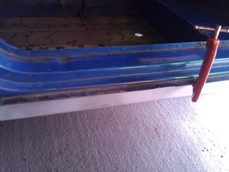

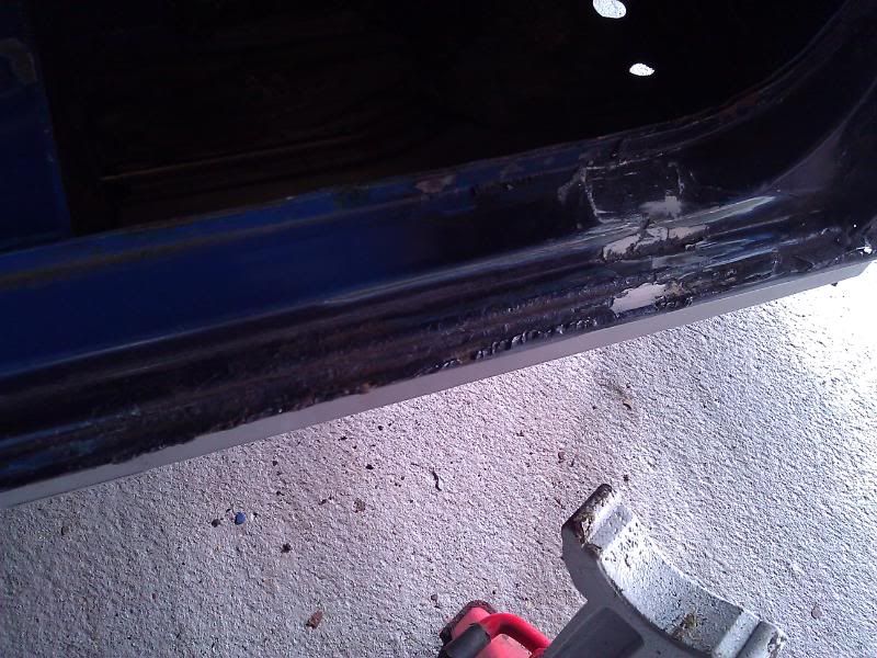

Posted 15 October 2011 - 05:50 PM
Bit of an update
Got myself one of these
And been busy this morning
