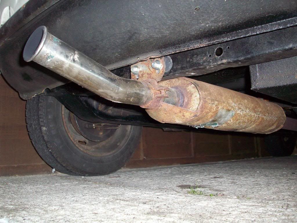

Here's my one;

#5
Posted 06 October 2011 - 11:58 AM
Best exhaustI have owned,
Excuse the rusty back box, it is getting stripped and repainted to protect it before it hits the roads again..
Dan..
EDIT : Mines maniflow, but similar thing
Dan..

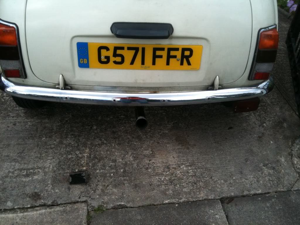

#6
Posted 06 October 2011 - 02:44 PM
Not an RC40 or even 1.75" but I love my exhaust none the less! Mines a PlayMini exhaust. It bolts through the subframe on the mount provided with it. Very sturdy!
#7
Posted 08 October 2011 - 08:01 PM
Solidly mounted to subframe, flexi pipe at front
