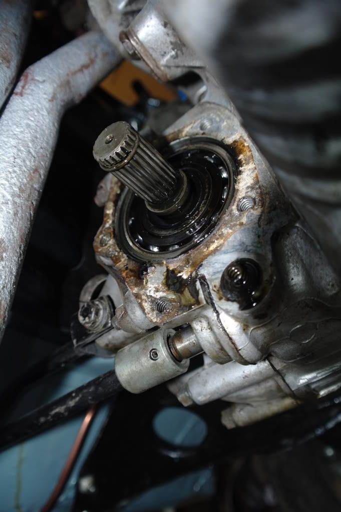

Right, I have pictures.
I took the pot joint out and that is fine. But the diff output shaft has play in it.
The pic is taken looking up and aft, at the right hand diff output shaft.

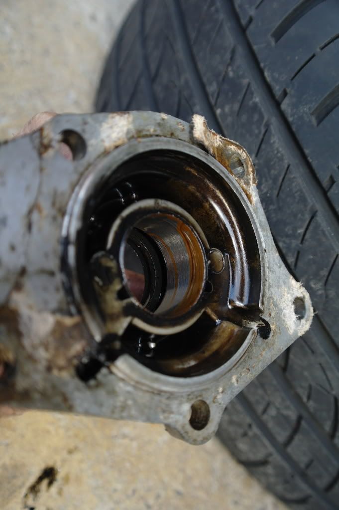

Here's the state of the cover plate. This needs replacing too.

#10 Guess-Works.com
Guess-Works.com
    Gearbox Guru
  • 19,838 posts
Posted 19 October 2011 - 02:57 PM
can't tell you much from the above apart from the bush in the output cover is well mashed....

Yeah, in this case the picture doesn't tell a thousand words. It's simply there to show the offending item. Is there supposed to be play in the output shaft, to the tune of apx. 3mm, and the bush keeps things all nice and straight? Or am I looking at a deeper strip to find out there's likely to be damage to the diff?

Posted 19 October 2011 - 04:11 PM
I suspect that the mica thrust has disintegrated in the diff unit which is giving the excessive play, if you can push and pull the output shaft in and out ( probably by about a mm ) then the thrust is no longer there.
To fix that it's an engine out job.

Posted 19 October 2011 - 06:04 PM
Right-o. There is movement laterally on the shaft. So; that's that, then. Looks like it'll be trailered to our new house. Thats robbed me of more than a few plans i had for her. No doubt I'll be giving you a call in the new year for a rebuild kit.
