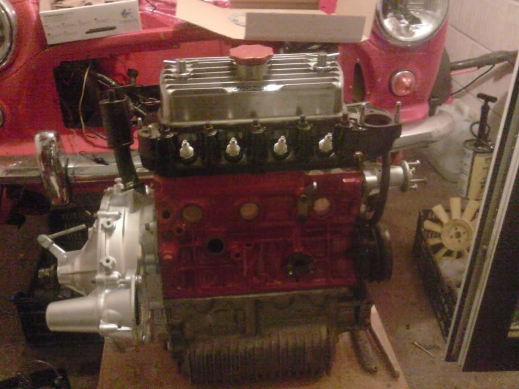

Well boys the clinder head is on just about finished, dizzy drive to go in and fit some ancilleries
what is the tappet gap you recomend might as well do it now before i put the engine back in
just a reminder 1275 12HA83AA 10.1

#126 Brookesy
Brookesy
  • 507 posts
Posted 15 November 2011 - 08:25 PM
Looks top notch! Must be pretty darn chuffed so far?

Posted 15 November 2011 - 09:23 PM
Yeah over the moon bud need to patch the block up after putting the core plugs in, the red looks crap in the photo
but in real terms its spot on, engine going back in next monday cant wait to fire it up

may i ask what the equipment is on top of the block in the first photo?

Hmmmm may just try and scrape some room in the garage in that case... saves moving everything half way through the build i suppose :)
It's a dti gauge bud with a magnectic base you will need one but to set your cam timing if you are upgrading it , i got it off ebay new for £14-50 plus a fiver postage
http://www.ebay.co.u...984.m1423.l2648 and
http://www.ebay.co.u...984.m1439.l2648
Both came next day delivery on stadard postage sorry disk was free postage
Edited by firefox, 15 November 2011 - 11:11 PM.
