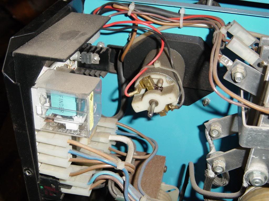

not sure this is the right place to ask this but welding in my floor pan tonight and wire feed stopped working? when trigger is pressed the relay on the circuit board energises but there is no power at the wire feed motor terminals? will it be the pcb? there is no fuse or anything else to check , anyone any ideas cheers!

hi! no its a 130 turbo i am a electrician by trade and there is no power to my wire feed motor, i think it may be a component on the pcb or the transformer hope someone on here might be able to help, have you looked into your problem yet or found anything?

hi took out the pcb this morning and checked it for dry joints etc everthing seemed ok run through wiring and checked connections, re-fitted it and still no joy then i noticed the power switch 2/3 was partially between the 2 and 3 , so i pressed it to 2 setting and wire feed works!! must have knocked switch to mid position which stopped the wire feed working, thanks for all the advice away i go!

It couldn't have tripped the thermal cut out could it? They can take a surprisingly long time to reset.

thats what i thought at first, but was definately the power switch 2/3 which i must have knocked and was in between (not switching either) cheers though

I had something similar with my ageing Sip 130T. A combination of 4 push switches gives 6 different power settings. If the one you want isn't pushed fully home, even though it may look it, nothing works...............
