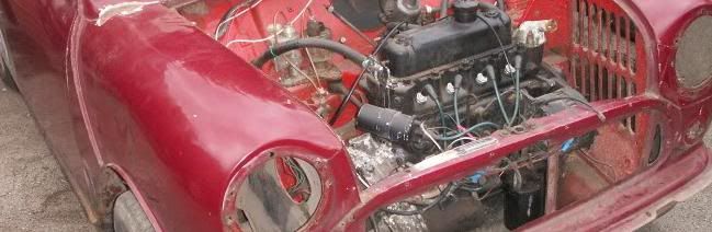

#9 midridge2
midridge2
  • 1,794 posts
  • Location: north east england
Posted 28 November 2011 - 08:58 PM
sorry for using your picture but this shows the brake pipe coming out of the cylinder nearest to the front of the car, now look at the filler cap, the clutch cylinder has the cap on the right and the brake one on the left.
