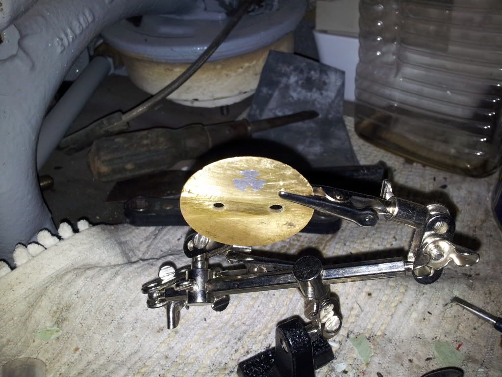

hi there, im curently trying to improve the flow for my hif44 carb to let more air in
ive knife edged part of the throttle spindle but as you can see from the piccture theres a weird spring thing stopping me doing the other side so well,
can this be removed?

Simply remove the little valve and solder over the hole. It's there to guarantee a supply of air when the throttle is closed on the over-run, for 'emissions' purposes.

As Roy said, remove the valve and solder the holes closed. The valve is hard to remove though. I seem to remember that part of the valve is threaded to the butterfly then the threads are soldered over to secure the assembly. Therefore, heat and cutters are required.

A grinder will make a bit of a mess of the butterfly disk. Nip the valve off with diagonal cutters. With the valve removed you will see what is left of the valve's threaded stem left behind in the disk. There will be a series of holes or slots around the threaded stem. Use a Dremel or small bit on a die grinder to carefully remove the remaining part of the valve so it is flush with the surface of the butterfly disk. Use fine sandpaper around the series of holes to clean both sides of the disk. Then use rosin flux and a BIG soldering iron to flow solder into the holes. Electrical solder will be fine. However, you need the big soldering iron or small torch to heat the disk so the solder tins the surface. If you leave a blob on the surface you are not soldering. Properly done the solder will tin the surface and fill the holes and there will be no blobs to get sucked into the engine.

Perhaps those disks are relatively inexpensive in the U.K. Over here they are not cheap and it is very common to find the original disks modified and plugged with solder. It really is not difficult and since you are working with the flat surfaces... not easily screwed up during the process.
And... the valve is not going to be on the modified disk so there is no possibility of it getting sucked into the engine. Once soldered shut the disk is sanded flat so solder bumps are not a problem with air flow either. Keep in mind that these mods are typically carried out with narrowing of the butterfly shaft. In the end, removing the valve and narrowing the shaft does result in a much more open flow path that can offer performance improvements.

Thanks for all your help guys,
Ive managed to fill the hole with solder and profiled it for a better flow, think ive done it quite well :)

That looks great.
