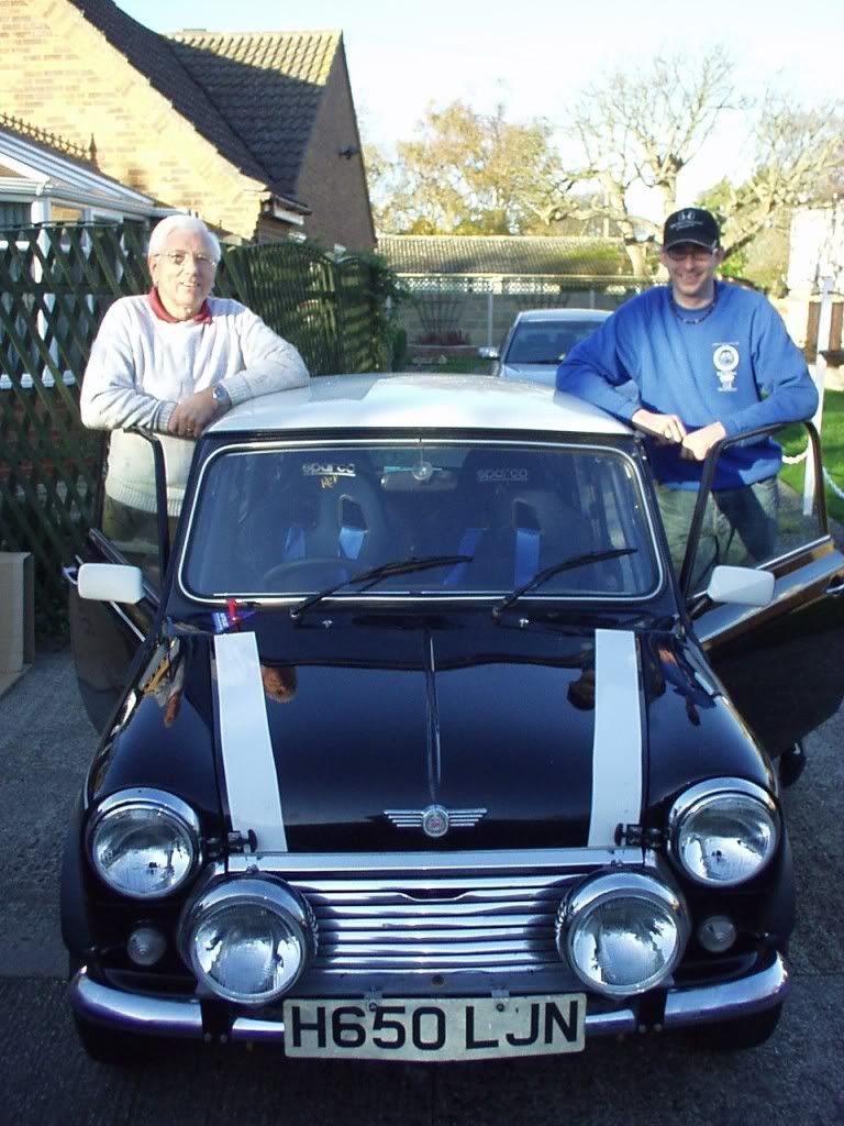

Posted 10 January 2012 - 10:30 PM
Here is my Endurance rally car with the Cibie lights, all with 100 w bulbs.
