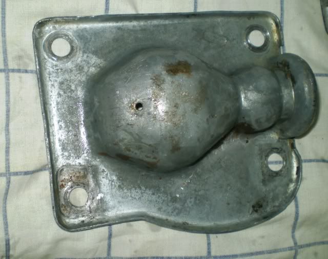

Hi i have a later type remote gearbox all syncro witha magic wand lever it uses a plate sililar to this bolted on the bottom of the remote .Posted Image
Sorry that went over my head :) So are you saying I can have a magic wand stick with a 1380cc engine with an upgraded gear box?? thanks!

This plate only works with the old type remote type change , this is what i have with a wand gear lever can take pic's of it tomorrow if it helps

The later type magic wand gear change as shown above (by Badchilli) can be fitted to any 4-syncro box 850/998/1275 (pre-rod change) so no reason why it won't be strong enough for a 1275/1380 engine with suitable gears. The only drawback will be the lack of a remote or rod gear change mounting to stabilise the engine rocking under hard acceleration, etc..............but you could try fitting other aftermarket engine stabilisors to compensate. The late type magic wand gearbox and parts or to convert are however quite rare to find these days as only fitted to some early Mk2, early Mk3 Mini's and early vans/pickups. (1967-74 approx)
"While the direct and remote change systems are very obviously totally different, they share the same gear selector mechanism inside the gearbox. From late 1968 when the gearbox went over from 3 to 4 synchromesh, they shared the same differential housing too - prior to that, the direct gearchange had its own unique diff housing with a small gearchange tower on it."
Diagrams here:
http://www.somerford... ... age&id=151
The later type magic wand gearlever 22A1382 is also different to pre-68, slot in ball is at top or side depending which.
