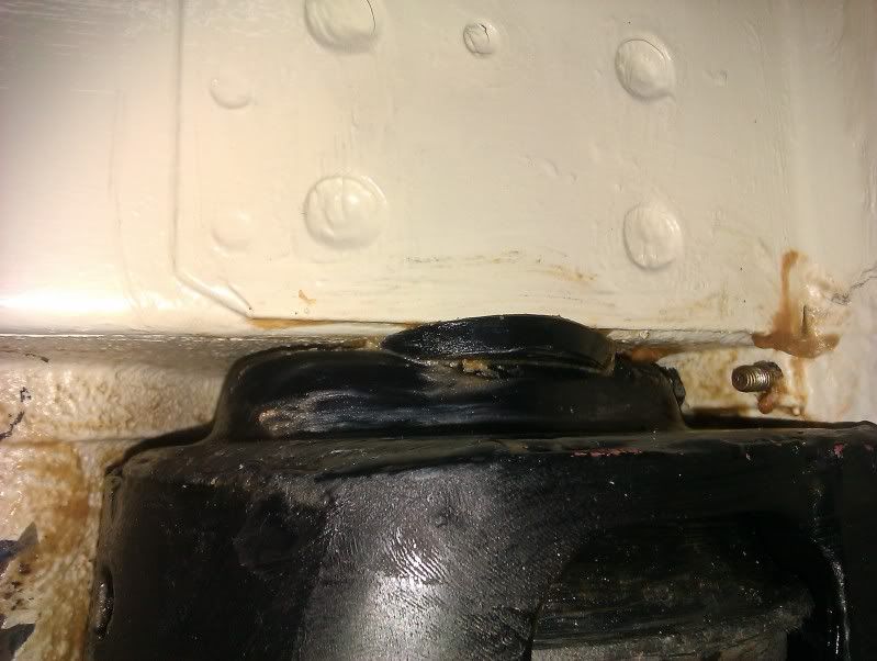

will try to upload a photo, but I'm on mobile at minute.
#6 mini670
mini670
  • 293 posts
Posted 18 January 2012 - 11:24 AM
photo taken yesterday
http://i98.photobuck...zE0NzcuanBn.jpg

What Minispares have sold you is rather pointless, a metal spacer between subframe and shell and a poly bit on top. If you have metal to metal contact at the bottom, what good is the poly? And, if the poly did allow vertical movement you would get rapid wear between the metal spacer and the hole in the crossmember. I would ask for a refund and get a proper solid mount kit elsewhere.
#8 tiger99
tiger99
  • 8,584 posts
  • Location: Hemel Hempstead
Posted 18 January 2012 - 11:30 AM
Correction, I read the Minispares site wrongly, the poly pad is at the bottom. But if, as claimed, the metal bush at the top stops sideways movement, it is putting a large bending load on the bolt. It is a substantial bolt, and is in no danger of breaking, but it will put an enormous fatigue load into the threaded part of the subframe. The design is just plain wrong.

Avoiding the argument on whether the use of solid & poly is right or wrong...
For the bottom poly mount to be squeezed as much as shown in the photo, does suggest the turret bolt is too high off the cross member, this could be due to incorrect fitting of the solid mount, a discrepancy in the thickness of the mount vs the original or the supporting tube in the cross member has collapsed and you're essentially squashing not only the mount but also the cross member.

could perhaps make a spacer to fit over the threaded part, effectively lowering the shoulder that is supposed to butt up to the subframe? this might stop the huge deformation of the poly bush

checked the cross memeber last night, all is well.
think that the alloy tops are twice as thick as they should be, as I fitted the original rubbers and the bolt nipped up nice onto the shoulder.
