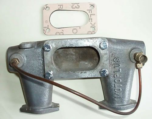

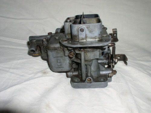

My plans are to fit a DGV weber, found on old ford xflow engines. i have contacted a jet supplier and they have informed me that the standard 1600 xflow carb comes with the correct jets to run on my 1275.
I have got a inlet manifold from ebay with the correct flange for the weber.
I have got the carb from the capri laser that is sat in my friends barn and was running fine before i removed it.

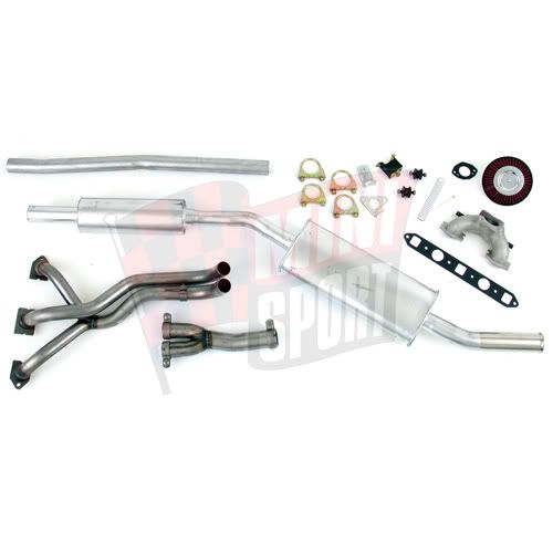

Last year i purchased a stage 1 tuning kit which came with a needle for my shot su, inlet mani, lcb exhaust manifold and a 2 box side exit exhaust.

Here is a picture of the carb.......
and here is a picture of the Inlet manifold........

Here is a picture of the tuning kit i got last year from minisport. obviously i wont be using most of this kit now i have the weber to go on....

 My first post !! Does anyone have or know where there is one of these Motoplus Weber DGV manifolds on this thread for sale ??
