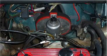

Hi All,
Was just wondering what the best air filter is for the Hif44 carb. I have the origianl airbox and filter on there at the mo, but am thinking of changing to something else. So what would you go for..... how much are they to purchase and how easy are they to install??
Cheers!!

If you want too make a lot more noise and a little more power, a K&N cone filter is the way to go, however depending on the spec of your engine it will make a (sometimes very) small difference to performance. Many people argue that best drivability is retained by keeping the standard air box, installing a K&N element and drilling out the front of the air box. Stays quieter, delivers a little more torque than a cone filter which is more noticeable when driving. Plus it's much nicer when cruising on the motorways! :P
If your feeling flush, there's the MED ITG stub stack filter set up, used on an old HIF44 set up, was fantastic, and did give a genuinely noticeable performance increase. However, if your engines only mildly tuned, or this is one of your first upgrades £90 is a lot of a money for an air filter! :P

Wasn't looking to spend that sort of money really. I was hoping to get rid of the airbox to try and tidy up the bay a bit, but if it's not gonna make it that much better I'm open to keeping it, but modifying it possibly.
It's a 1275cc standard engine with Hif44 carb as far as I'm aware (only owned it a few months).

If you want the best performance for what the part does (i.e. hight flow with good filtering) get the ITG with the MED stub stack, will be the best flowing vs the k&n.
but if you cant afford it then, just get a k&n filter element and put it in the stock box + a couple of holes on the front and underneath (bout 4x 1/8" dia. in front and 2 underneath), much cheaper and better flowing than a conical.
I think it looks kinda cool any way :-)
JUst needs to be a bit tidier around it :blink:
