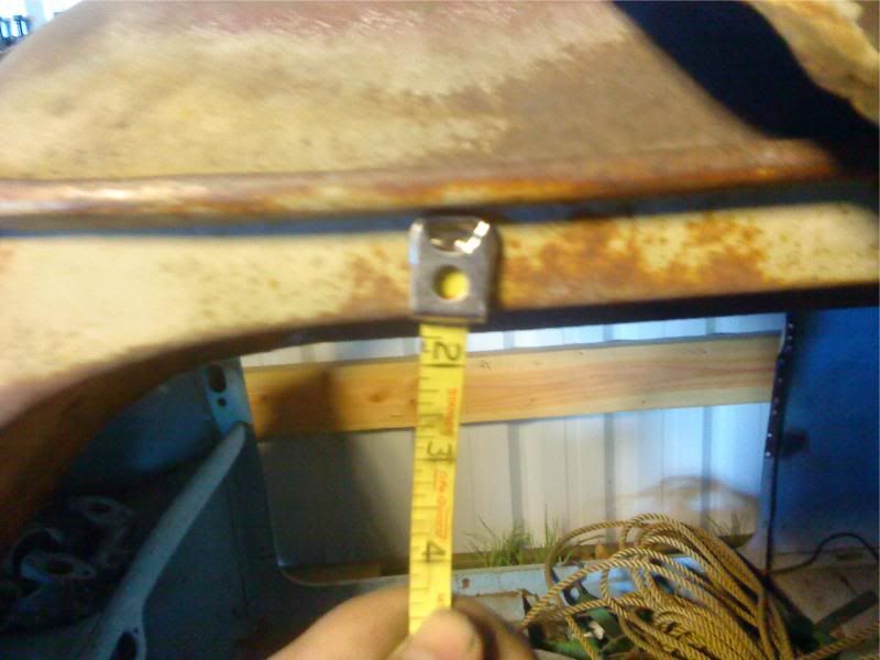

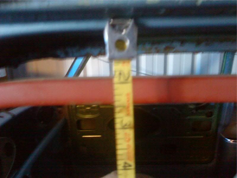

Not really, I would estimate my door is probably 1/8 inchy or so low in that picture due to it just sitting there and not being attached, but here is the big difference in height.
Mk4
Mk1
They are nasty blurry but it's still obvious
Chris
