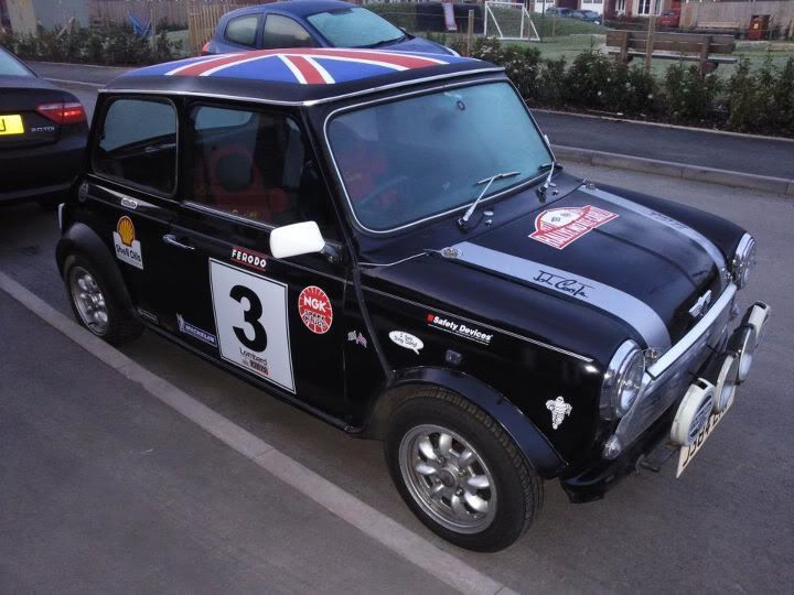

#11 animale
animale
  • 160 posts
  • Local Club: Minis n Oatcakes
Posted 02 March 2012 - 09:39 PM
Here she I anyway
