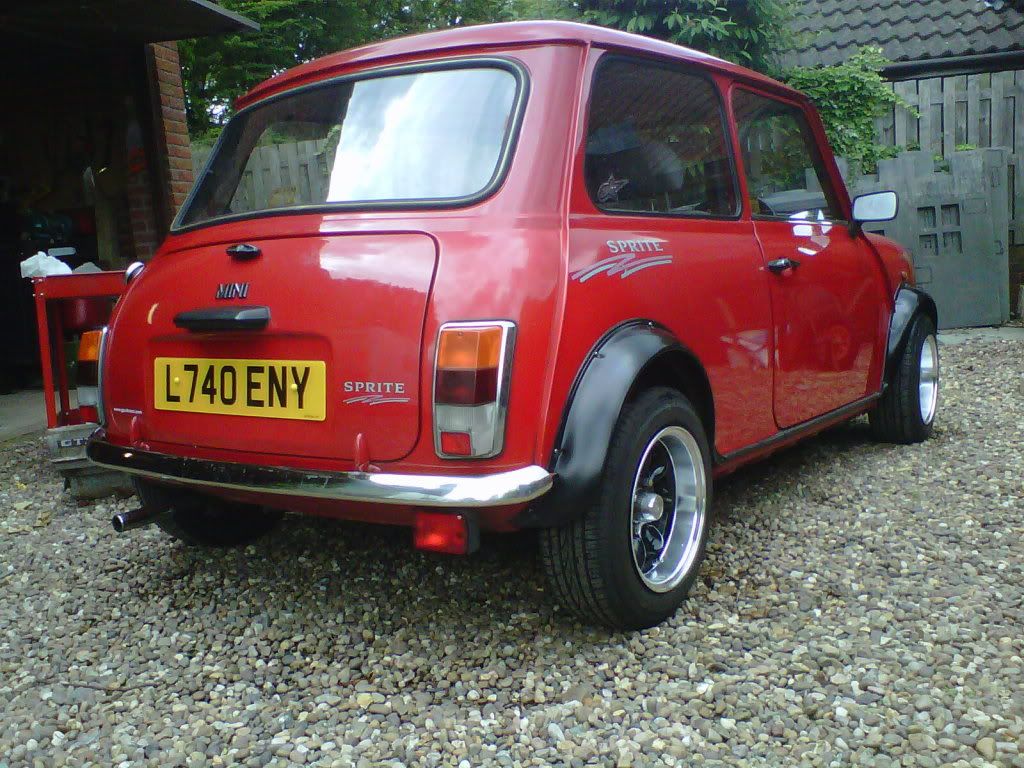

Been on the forum for a while now, just quietly watching what's going on and thought it was about time to show you all our project - Lenny the 1275 track car
All the work will be carried out by me and my dad in the garage, mainly to teach me how to restore/modify a car i.e welding, spraying, filling etc, and how the car works. The aim is to get it fit for hill climbs by the time it gets to summer!

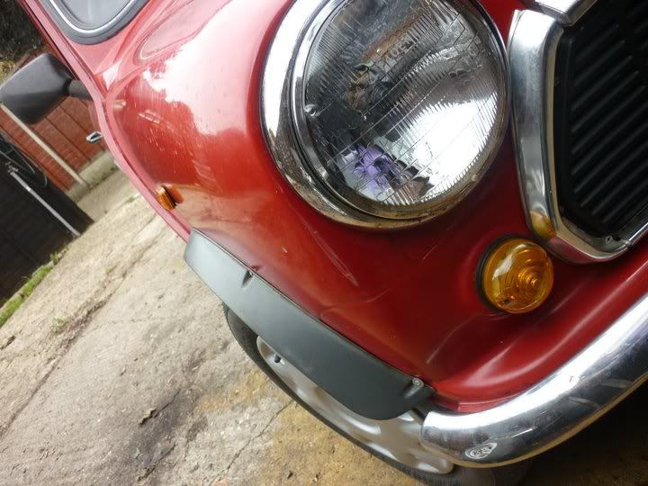

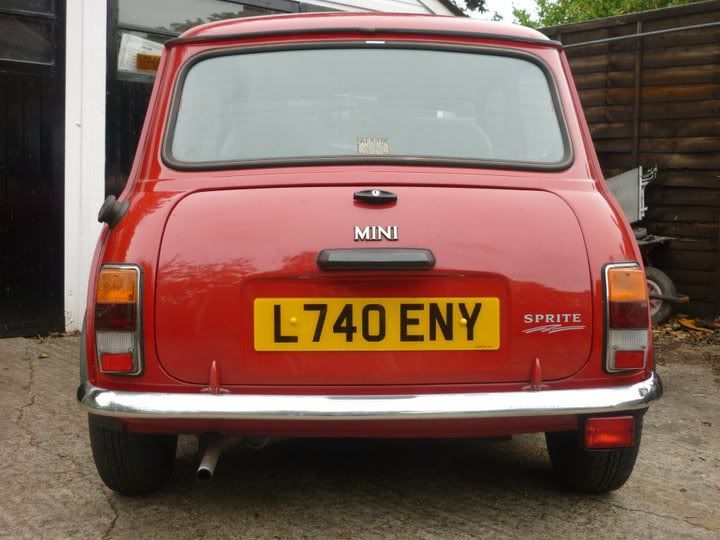

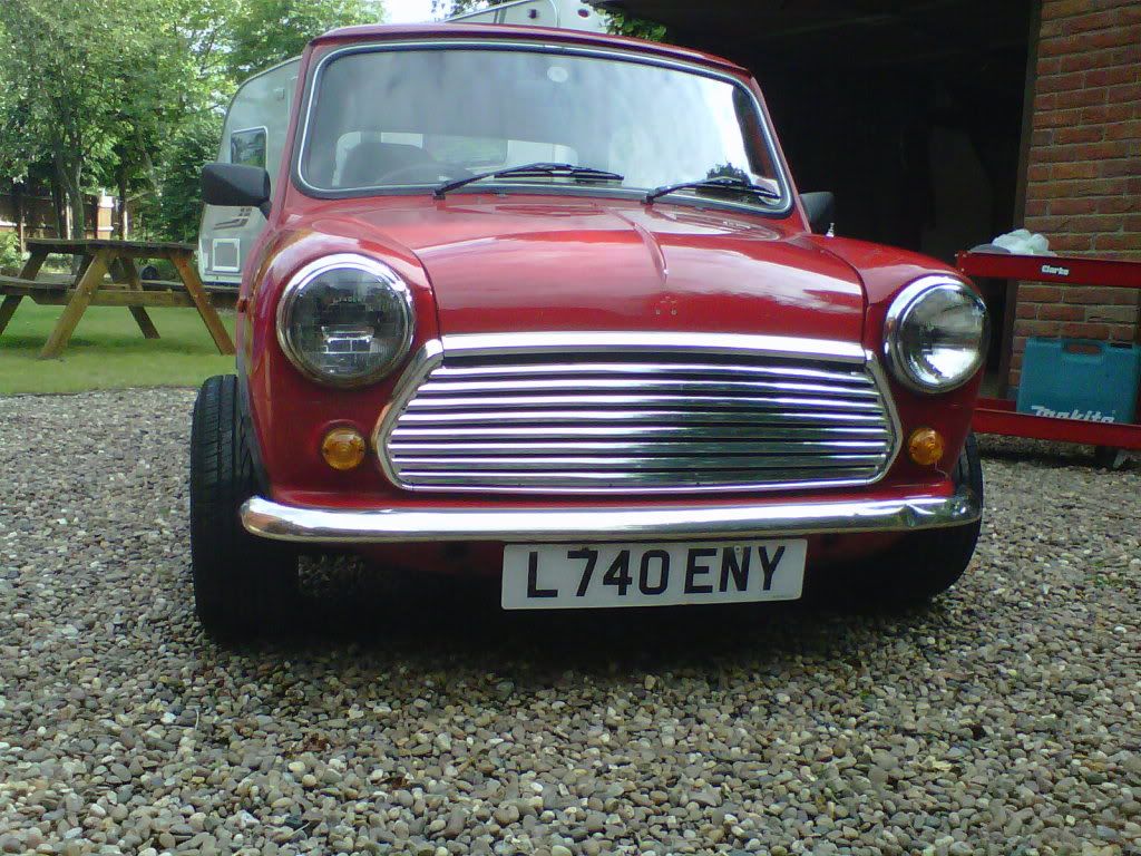

This is how it looked when we picked it up:

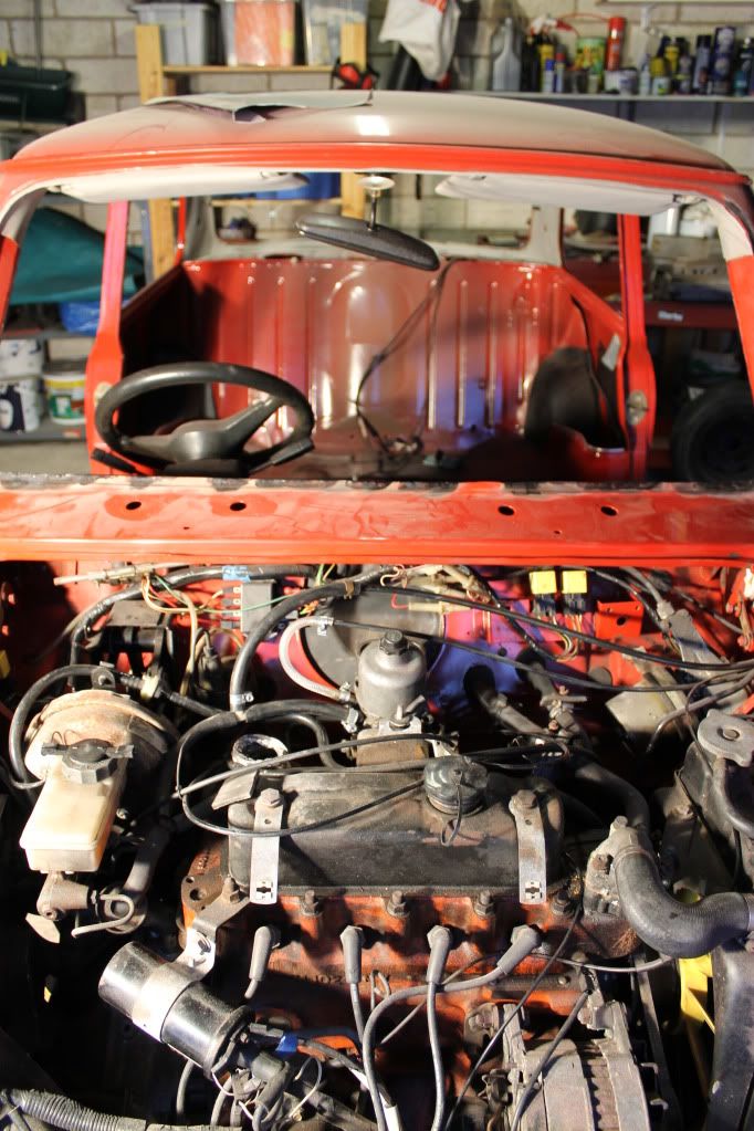

After fitting 12x6's and group 5 arches and driving it around like that for a bit, the time finally came to begin the rebuild. So, once I was home from college I parked it on the drive and began the strip-down:
We then rolled it into the garage knowing that it wouldn't be coming back out for a few months, which was sad but I knew it would be perfect once it finally returned to the world ;)

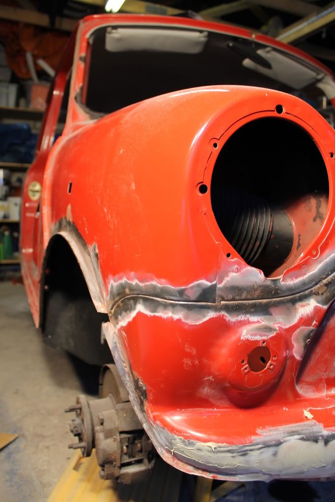

Once we'd got it in the garage we stripped back the paint where bubbles were forming, mainly under the windscreen, below the doors and on the front valance. Once these were treated, we poked around in the boot only to find a hole in the floor which needed sorting out. We ground out the hole/patch of rust, cut a piece of steel to fit and welded it in, ground down the welds and job's a good'n! No pictures cause I forgot sorry :/

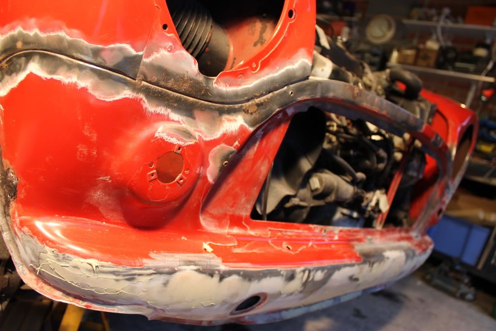

As we were around the bumper area and had the welder out, it seemed like a good time to get de-bumpering! After much deliberation over what type of bumpers to run on the finished car, we eventually decided that no bumpers at all would be best for a clean, racey look so got to work grinding off the rusty lips and welding up the seems. We found that grind a bit, weld a bit was the best tactic and stopped the valances from falling off like in some of the horror stories I've heard about!

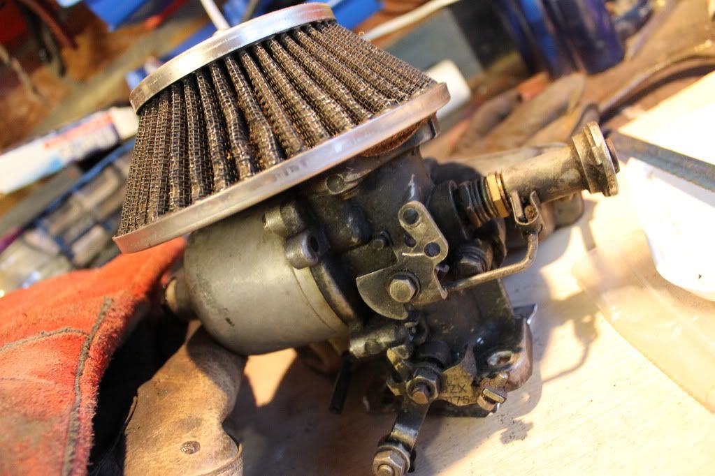

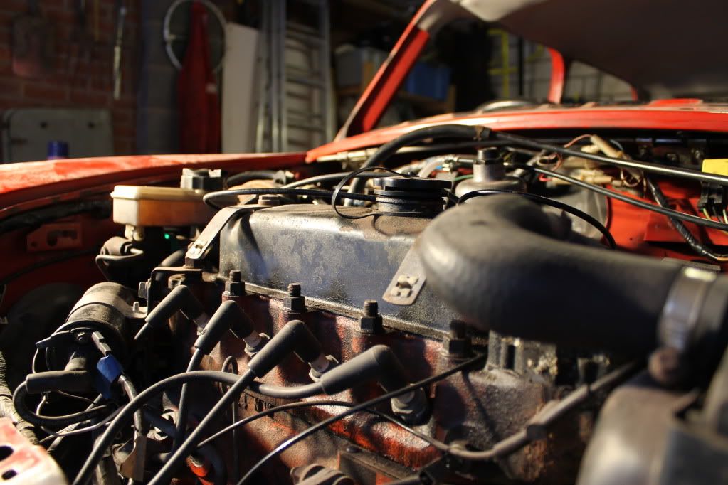

Once we'd skimmed these with filler we went about fitting a sportex 3" cat-back exhaust (which tucks nicely up against the rear valance and doesn't stick out too far) and started the engine for the first time in about 8 months. Sounds like an absolute beast! Really deep note with some nice rumbling on tick over, well worth the money. Once a lack-of-fuel problem was sorted (put a bit of fuel directly into the carb to get the engine turning over and clear the fuel pipes of air bubbles) the engine started straight away! (see the exhaust above ^^^)
