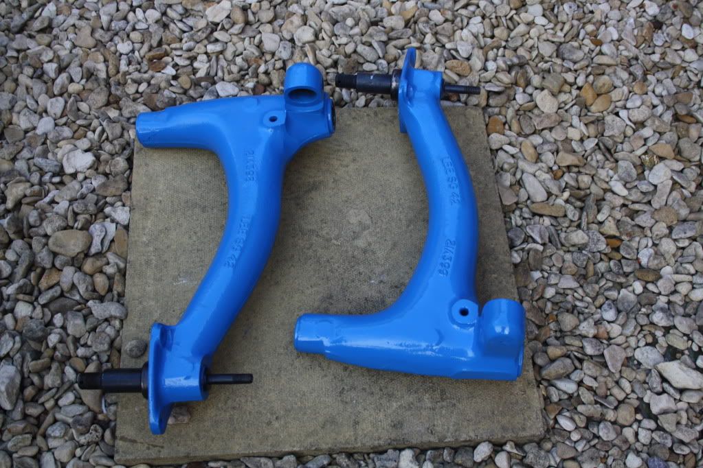

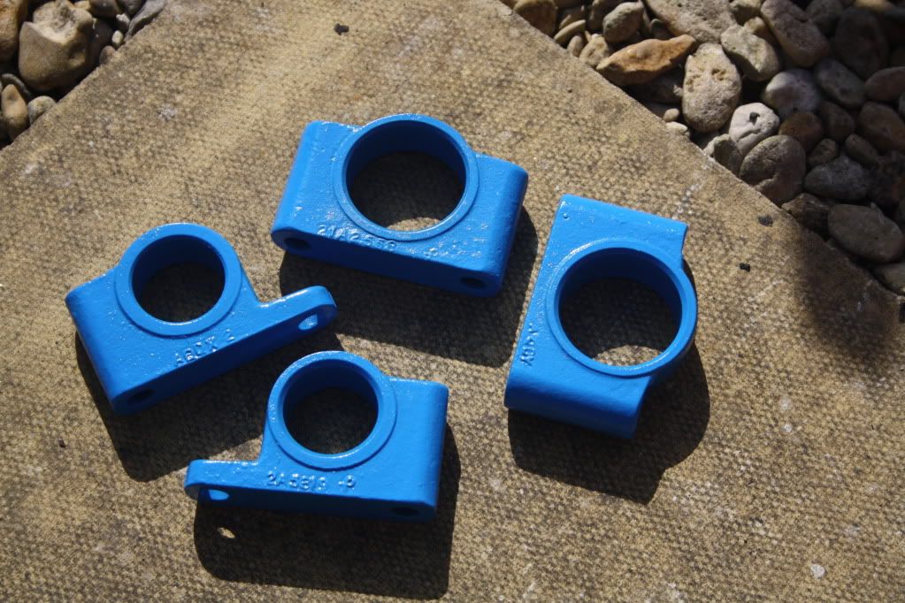

Here are my freshly painted Radius Arms. When we got them off they looked awful, but after a clean, lots of wirebrushing, kurust, primer and a few layers of paint they came up quite well:

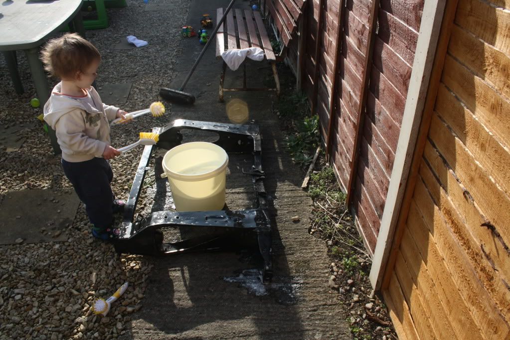

After numerous hours of wire brushing the subframe itself still needed a good clean. So this afternoon in the absence of a pressure washer, or even a hose, my 18 month old thought he should lend a hand with some soapy water and brushes:
Those nooks and crannies were a pain, I ended up using a scraper to get the thick muck off, a pressure washer would have been so worth the money, i'm now dreading having to do the same for the front subframe when we get round to taking it off!

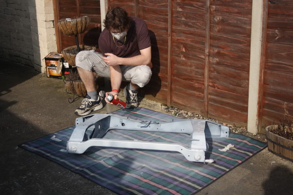

My husband Wez will be finishing off the subframe wire-brushing this evening ready for me to Kurust it tomorrow – in time for a weekend of etch priming, stonechipping and painting. We are child free on Saturday so will hopefully get lots done, here's hoping!

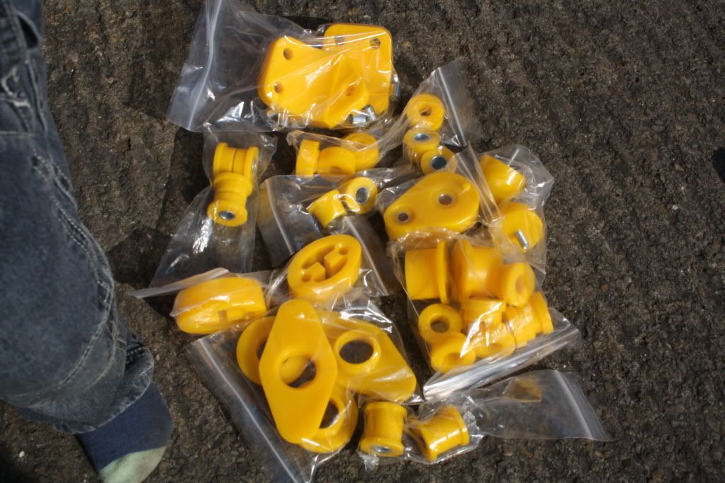

Just a quick update as my new set of bushes came today and i wanted to show them off. Not too exciting i know but they're the first thing we have bought for the car since deciding to start up the rebuild again :D

Have now Kurust and primed the subframe, hopefully finishing that off tomorrow - just hoping the weather stays nice :shades:

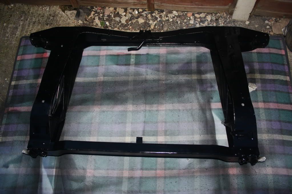

We did manage to stone chip and then top coat the subframe, one more layer of topcoat which I'll do tomorrow and it's done:
Not impressed with the can of Stone Chip Shield though, it blocked up every couple of seconds and tipping it upside down and spraying for 2 seconds like they suggest just seemed to make it worse! I haven't seen anyone else mention this issue so maybe it was just a bad batch? We decided one thin coat would have to be enough, I was going to spray the underside of the car with it but not now – will have to see if you can buy some paint-on Stone Chip instead or go down another route...

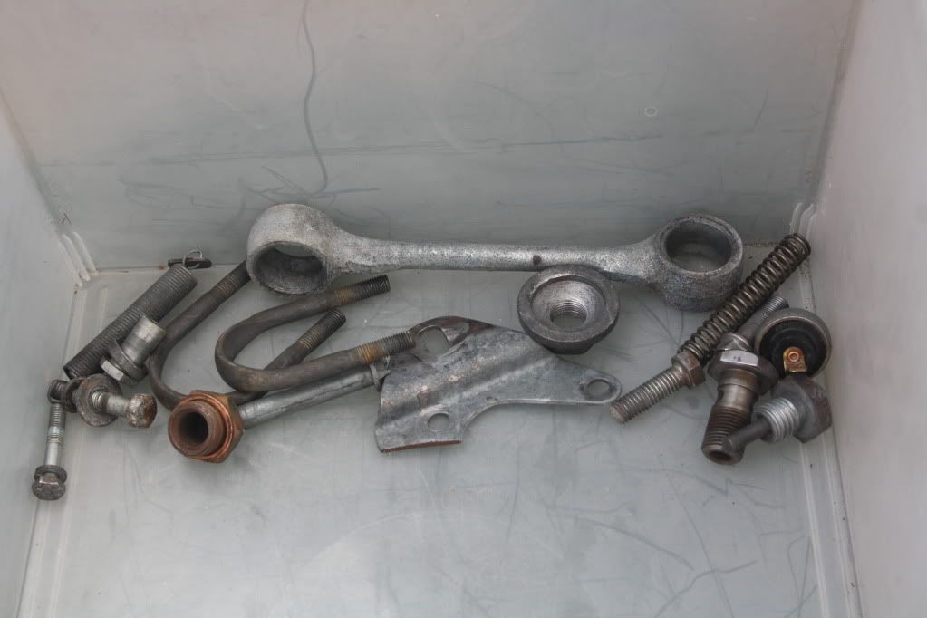

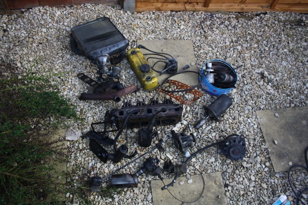

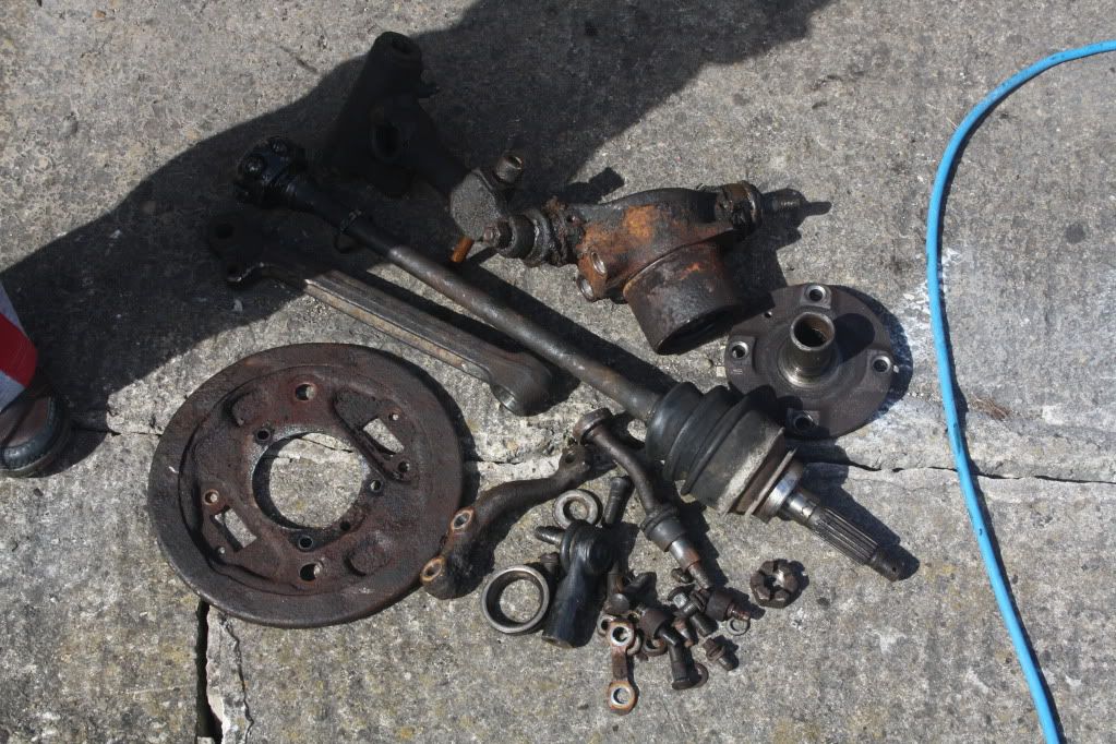

Here's a pile of components from the engine bay, slightly concerned that we're never going to be able to put it all back together! The idea was to do it in a methodical way, keeping all the bolts nice and organised – but that went out the window pretty quickly :s
Hopefully we will find a way round this or just wait until we have the right sized socket and take the sub off with the gearbox and engine still attached. Once we get the rest of the engine out I can clean up and wire brush the engine bay, I know there's at least one patch we will need to weld, hoping we don't find anymore!

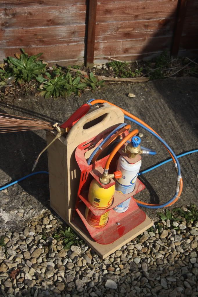

On a more positive note the welder arrived courtesy of my dad:
As you can see it's a very basic Oxy-acetylene unit. I'm hoping this will do the job ok – although it's going to be more about what I can do rather than the welder I think. Going to spent any spare time in the week practising – not looking forward to replacing the gas continuously though, I think it's going to get quite expensive! I do have an arc welder but don't think I’m going to ever be good enough to use it, maybe for spot welding, we shall see.

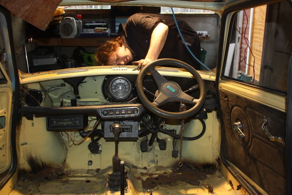

The dash... and the husband :proud:

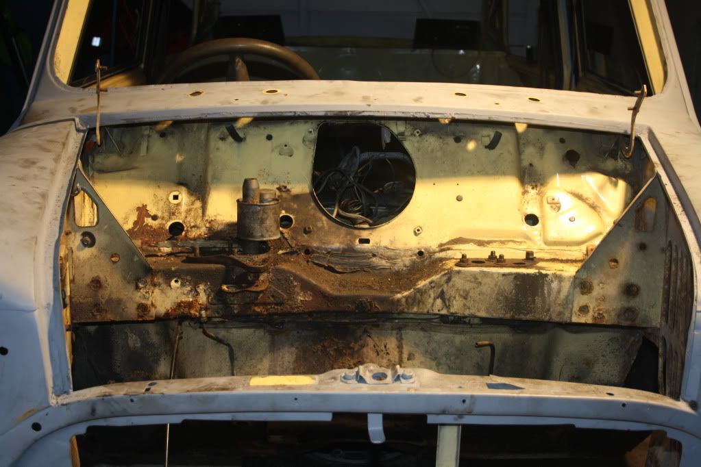

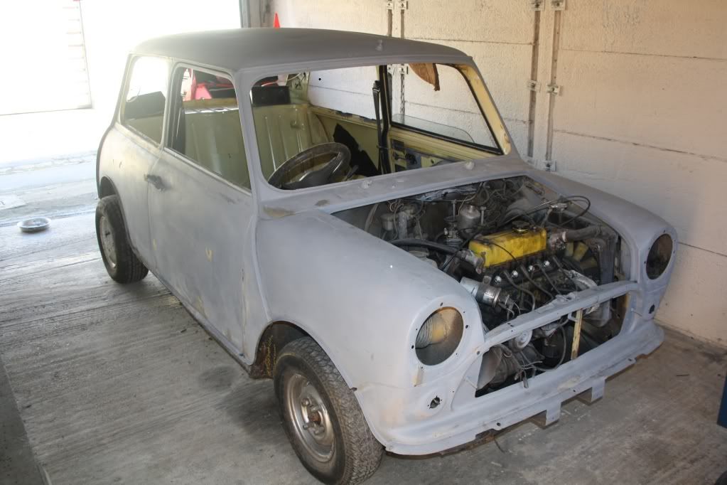

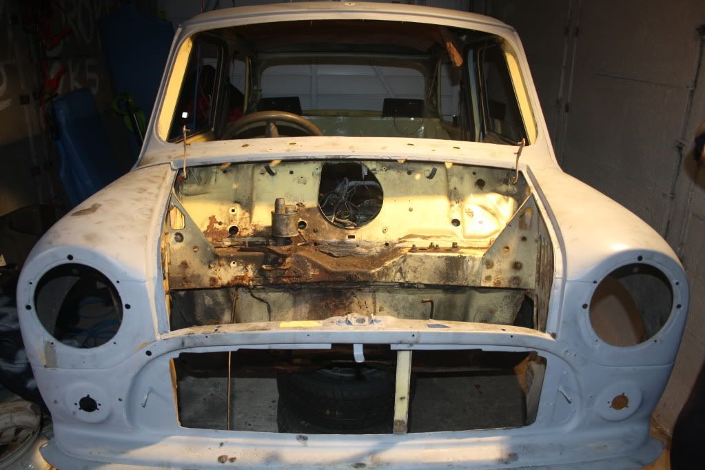

It was still a more productive day than we imagined, even with the hiccups, and still enjoyable (for the most part!). Here's the engine bay now:
A good go with the wire-brush tomorrow will hopefully only reveal minor surface rust, we'll also be stripping the subframe and I'm completely prepared to resort to using any means necessary to get those stupid hub nut/ drive shafts off. Same goes with the passenger drum brake with the rounded brake adjuster – they're coming off whether they like it or not, even if the damage done means they will need to be replaced! We'll have to do it all within a 1.5 hour window while baby's napping though.

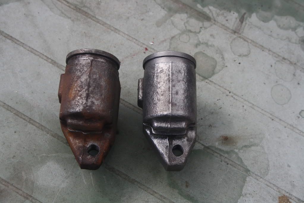

While I was busy, Wez, the legend that he is, managed to get one of the wheel units completely stripped. The brakes aren't looking as bad as I first thought so we'll get everything cleaned up nicely and then decide what can stay and what needs to be replaced:
He also had some fun with the wire-brush:
Before and after!
