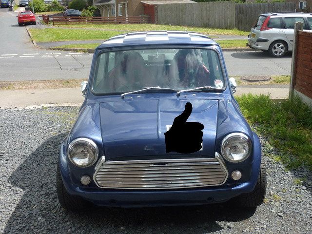

To my knowledge I have a MK1 bonnet hence why I can't but the top chrome piece on, I was wondering if I bought the Mk1 moustache I could remove the sides and fit it straight on?

no you would need a new grill as well

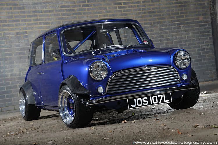

I'm sure most have seen this mini before but easier than explaining haha, I wanted to go for this sort of look (grill and tash)

yeah thats a mk1 grill (i think a morris grill) and tash

no the MK1 grill is differant to yours if u look at your grill it sort ot tucks in at the base where as the MK1 grill doesnt tuck in so the tash wouldnt line up with the grill

Mine originally had the same grille as yours, but i removed it. Removed the lip from the bonnet and attached the grill and tash as i described in the previous post i made.
It does fit differently, if you take the grill you have off, you will see a recessed section. The Mk1 grill basically fits in that recessed area.
