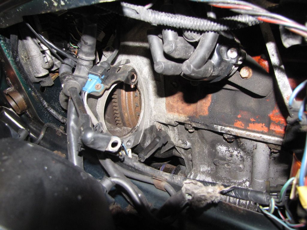

can you tell me where is the crank sensor located? or a pic will be much better!!

It is the black plug below the starter hole. It is held with two hex head screws. Mine was very tight in the round hole where it fits. I had to use some WD 40 to wiggle it out. Its connector is the blue one.
