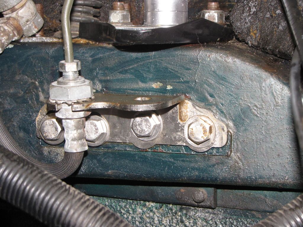

i assume you are referring to nut under clutch reservoir. For some reason they were Metric on my 94 Cooper. I used a 13mm box end wrench and plenty of penetrating oil. Only MiniSpares has the plate:
http://www.minispare...id=33837&title=
i had to replace the lower bracket too and I found this bolted on one made out of stainless steel from Seven Enterprises here in the US.
http://www.7ent.com/products/dogbone-mount-repair-bracket-for075.html

Thanks for the quick replys, on the first pic posted by xrocketengineer its the nut on the right that im trying to get too, but dont have much room to play with, do i need to take more bits off?

modandmini,
It has nuts with spring washers on the inside. The one on the right of the picture is the hardest one to install. You need a helper outside to hold the bolt while you install the nut and washer from inside. Once it is on, a socket with a long extension will fit inside but it will be tight. The nuts and washers for the other ones can be installed easily through the bulkhead holes for the brake and clutch push rods.
richie
You can not remove the nut with a socket and probably an open end wrench will not fit either. A box end wrench works perfectly.

You are right that the master cylinder studs are captive. I could not get 1/2" socket nor wrench to fit, 13 mm was perfect which surprised me. As you can see in the picture the nuts are not rounded off.
The spring washers and nuts that I am referring to is to secure the lower stainless steel bracket on the inside answering modandmini's question.
