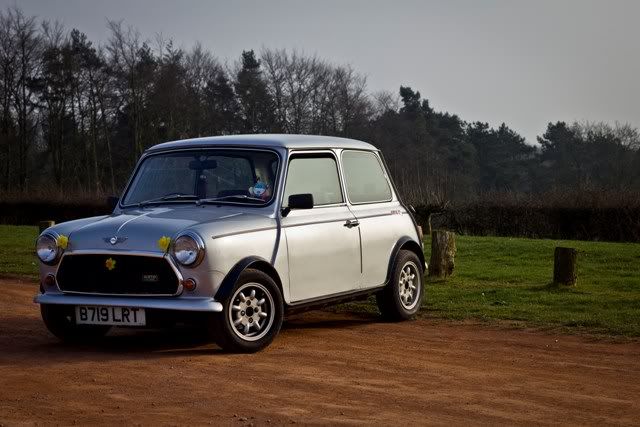

Well i got different wheels to the ones i linked in the original post - with an offset of, as it happens, ET31.
They are fine for me, but they do rub slightly on full lock I find (not bad enough to worry about i dont think)..and they are fine with standard mayfair plastic arches, they fit well, they fill the arch but dont protrude past it :)
But as people have said mini's tend to be slightly different lol, so yours might rub a bit more, or not rub at all..you should be alright though :D

Awesome mate they look sweet! Really suit your Mini, with the white bonnet stripes too.
Might have to see if anyone from my local club have 5x12's and see if they fit on mine. Best way to go about it without buying and loosing out if they don't. Cheers mate :D
