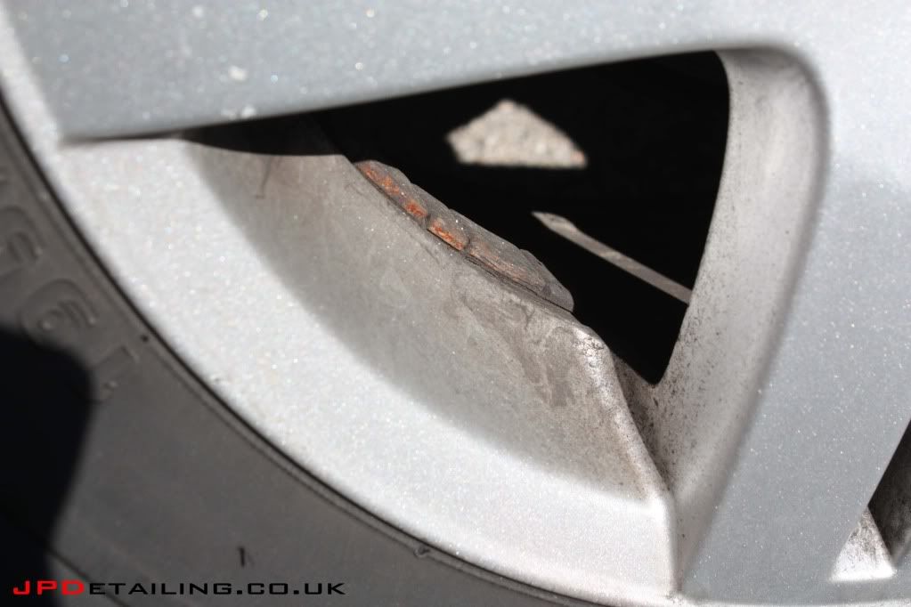

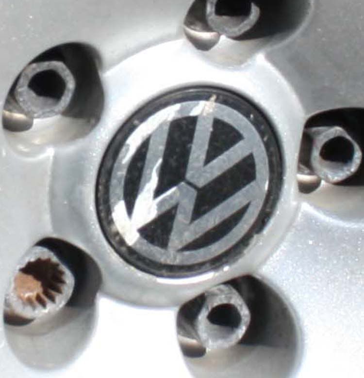

Unfortunately, there are a lot of acidic wheel cleaners out there that in the long run, potentially do more harm than good. This doesn’t just apply to wheel cleaners, but to bodywork cleansers too. Have you ever noticed centre caps and car badges sometimes have this weird white bubbling on them which ruins it?
This is that damage. Always try to use PH neutral products. Some of the best are only available online. Personally, I use Bilberry and Dodos mellow yellow. Strong cleaners with a gentle touch. There’s more out there that are great, it’s all personal preference.

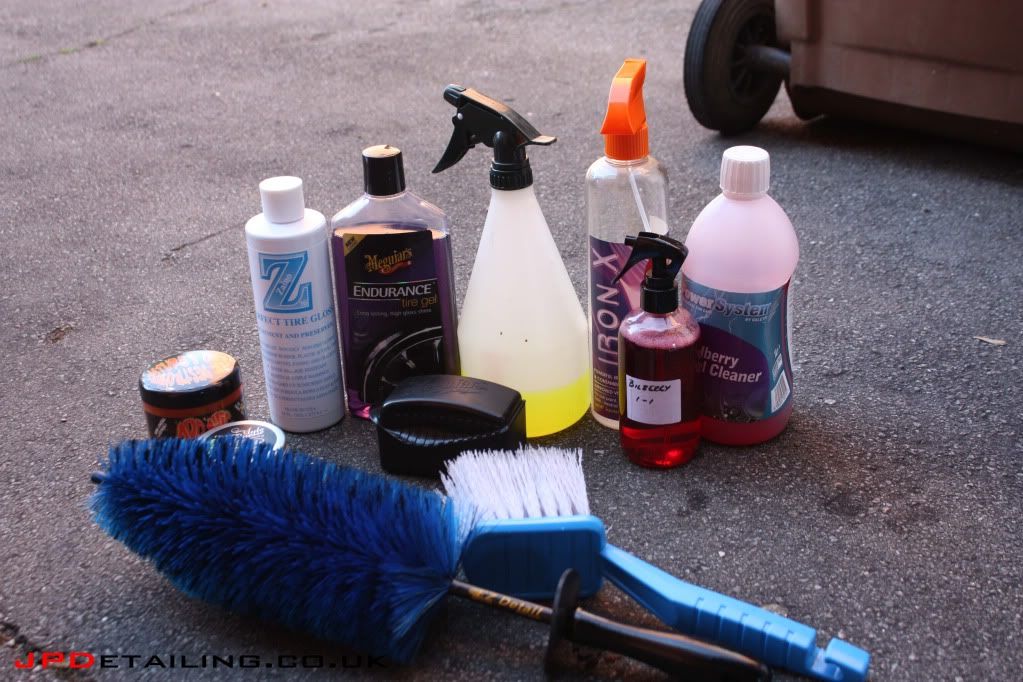

What you need:
  • Wheel brush – EZ brushes are some of the best around
  • Tyre brush, anything with a semi stiff bristle
  • Wheel woollies – Soft giant cotton-bud like tools. Great for hard to reach areas on wheels (I didn’t use these on this guide today)
  • Wheel cleaner (Bilberry or something similar
  • All purpose cleaner
  • Iron-x or similar product
  • Clay bar
  • Tar spot remover – Might be needed if there’s some stubborn bits
  • Drying Towel
  • Wheel wax
  • Tyre gel/liquid

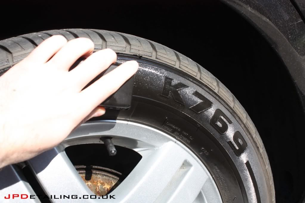

  • Spray APC over the tyre
  • Work in well with a tyre brush. Do this twice if very dirty
  • Rinse the tyres

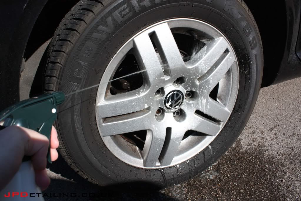

  • Spray wheel cleaner onto your alloy

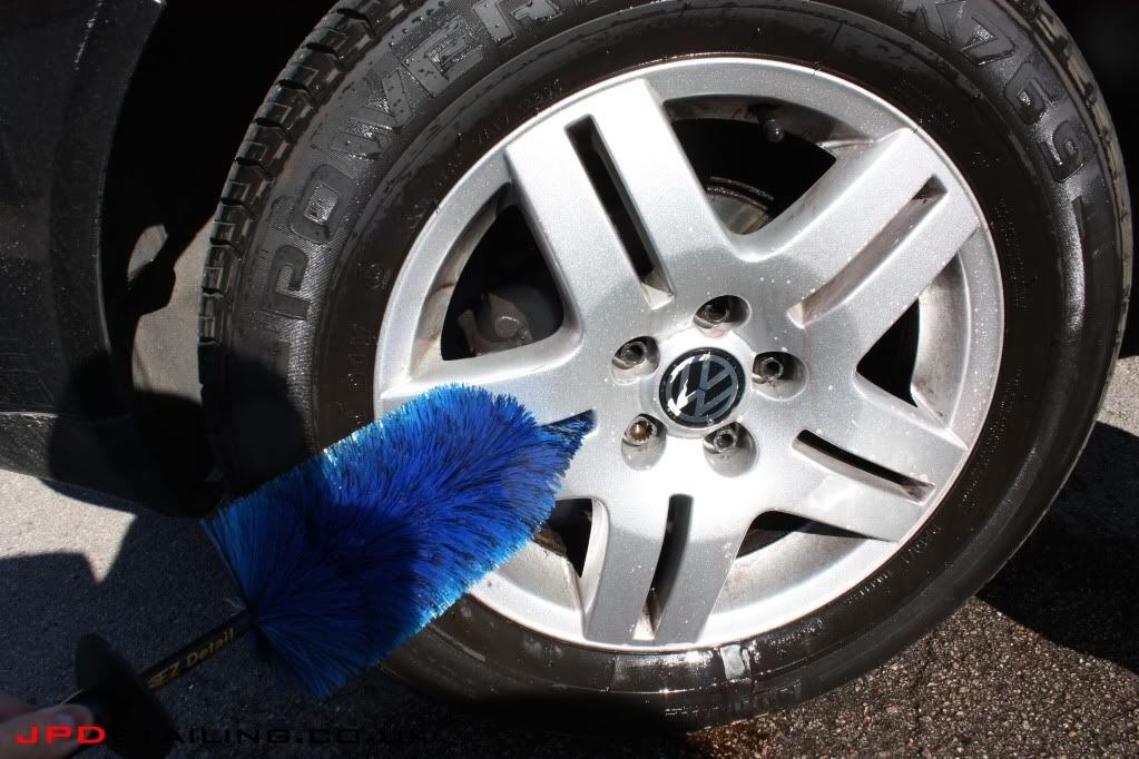

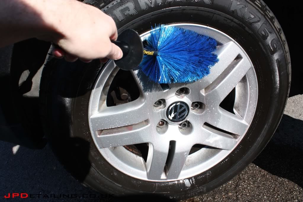

  • Use the alloy brush and work it in gently. Thoroughly cleansing the wheel.
  • Rinse

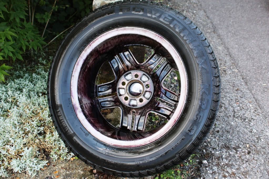

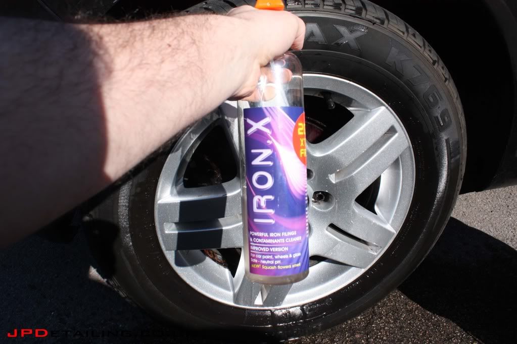

  • Spray on Iron-X. After 10 mins, your wheel should look like a purple mess (this is good). It’s removing all the iron, tar deposits, brake dust and other fallout from the wheel.
  • Rinse well

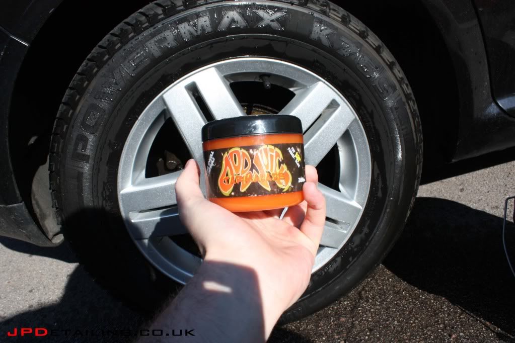

  • Apply a thin layer of wax
  • Leave for 10 mins, and then reapply another thin layer of wax.
This leaves your wheel the cleanest it ever has been and will be. It’s protected so the elements and salts wont damage it and it’s now a doddle to clean in the future.

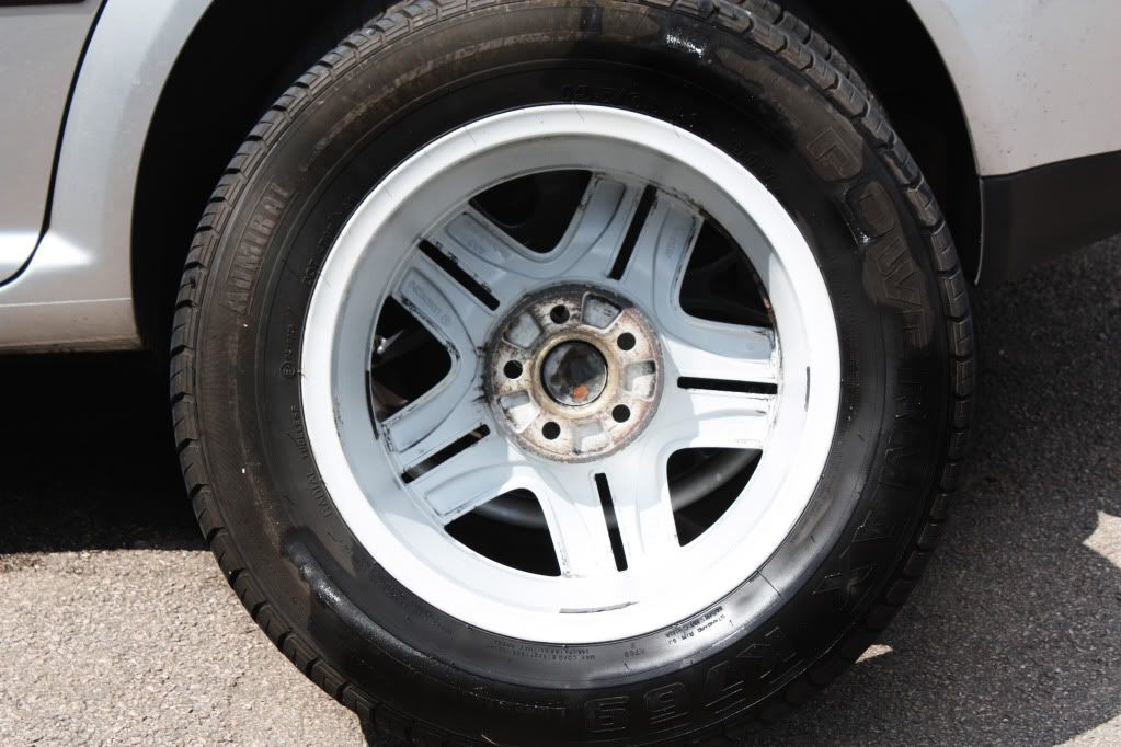

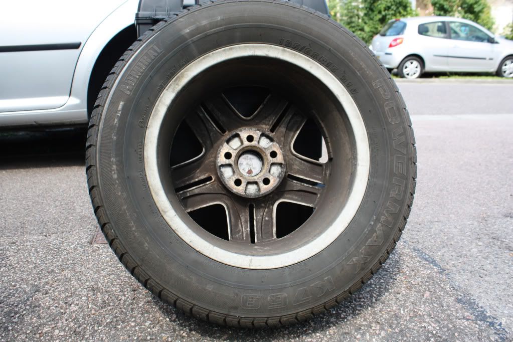

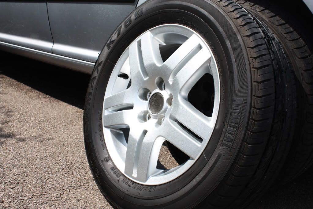

This is a fairly beat up old wheel which I just quickly detailed to show that even one as boring as this can shine gloriously.
Here’s some pictures of the process
Spray APC onto tyre and Alloy
Work in with tyre brush

Get in there my son! (with a wheel brush)

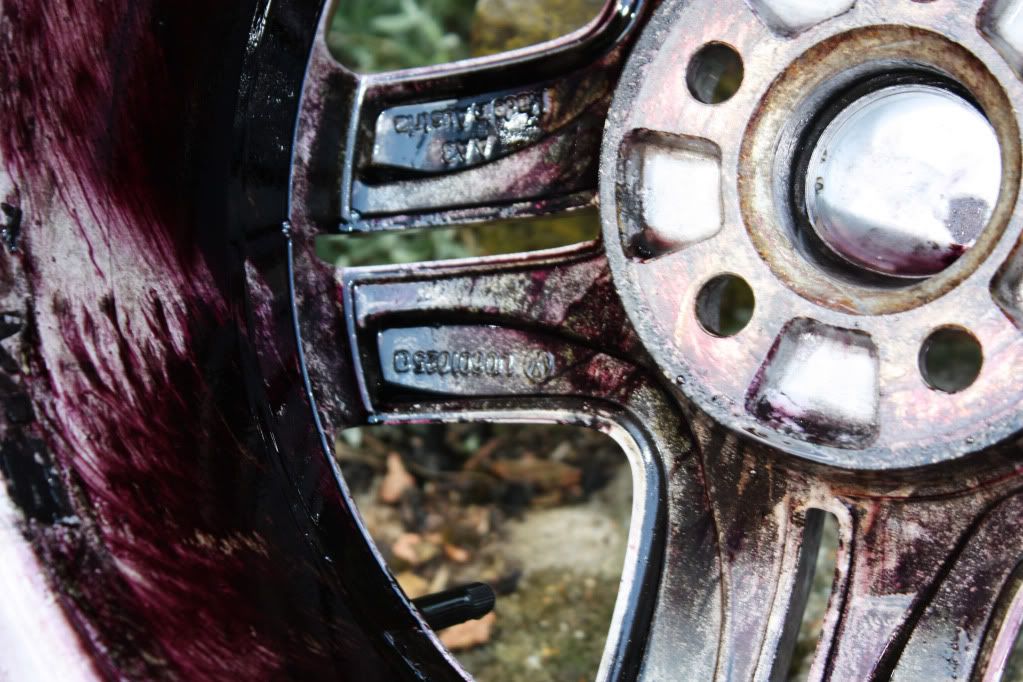

Now time for Iron X
Iron X doing its thing

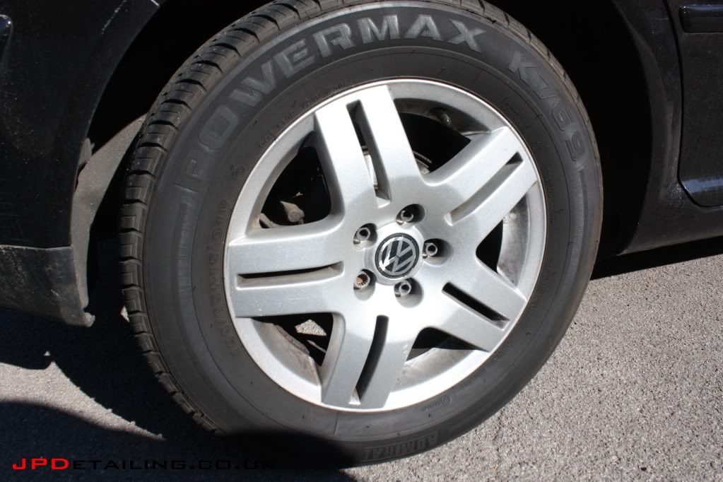

WIDE OVER, QUICK RINSE AND DRY

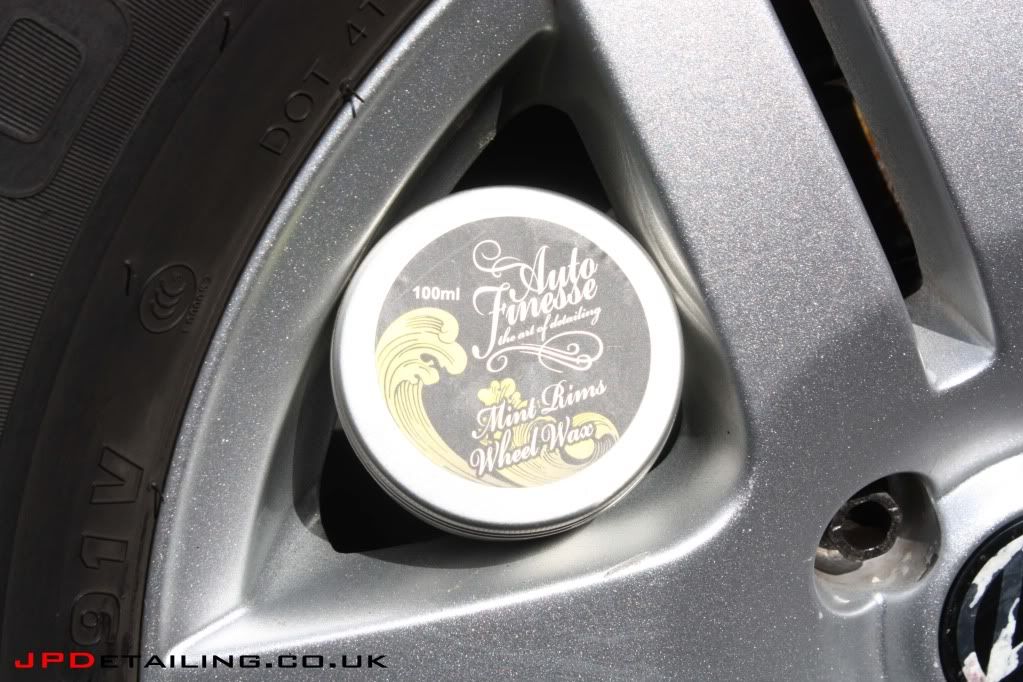

Now time for wheel wax

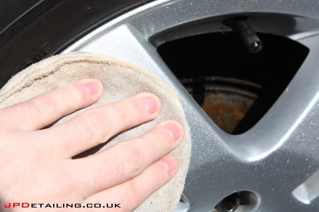

Working it baby

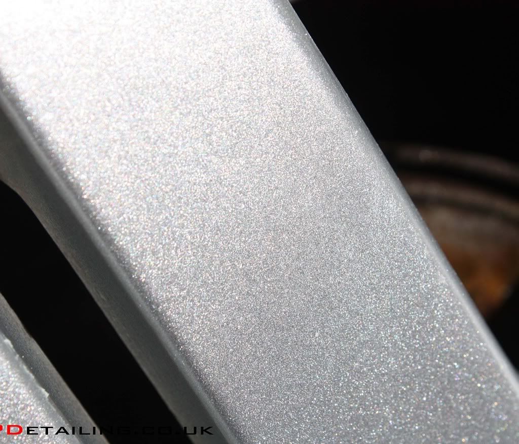

Just look at that flake pop :shades:

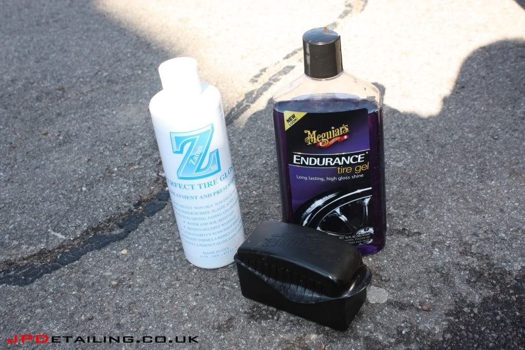

Now, either of these are good. I like Z-16, but as Megs is readily available from shops, I'll use this for this guide.
Work it in (apply twice)
Tah-Dah!

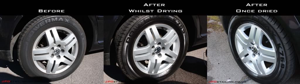

And after the tyre dressing has dried
Some before and afters
And heres the products used during this guide
About 6 months ago, to demonstrate how clean you can get a grubby wheel, I did a full blasting of a spare I had lying around. Did the front and back. All sealed and using the processes above. Here’s the result.
DURING CLEANINING
AFTER
Because of the state of this...it took a fair while as you can imagine.

  • Make sure your applicator pad is slightly damp when applying wax. This will make it easier to spread.

  • Don’t use acidic products. As you can see from the pictures above, the finished result is ruined by a damaged centre cap. Acids don’t just destroy caps, it contributes to bubbling on the alloy too!
