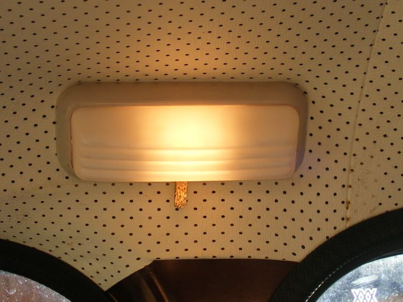

If you find someone with an old shell they are cutting up and buy the piece of the roof rail that houses the light holder.
Drill out the spotwelds and rivet it in place. (not over the headliner bar hole as I did at first)
Run 2 wires parallel from the lamp holder on the passenger side and the 2 lights will work together.
If you want brighter. I fitted these in place of the bulbs.
http://www.ebay.co.u...=item336477d8ca
Held in place with a hot glue gun and wires soldered to make the connections. Makes quite a difference.
Hope this helps
Regards
Steve

Hello Steve, thanks for the post and the photos, I also have to say steve what a fantastic job you have done with your daughters mini, just been looking at the big thread, WOW springs to my mine...
I cant say my own mini will get quite as much attention as yours or be half as good either when its done but I will try my best with mine and try to enjoy getting her how I want it. I appriciate your suggestion but thinking about the interior lamp issue, I wouldnt mind coming up with a plan to add another light but without removing the head lining.
I am thinking about making a bracket and attaching it from the centre front area (around the rear view mirror ) and attaching a light to this, but I tend to have rolls royce ideas and only push bike money lol
Chris.
