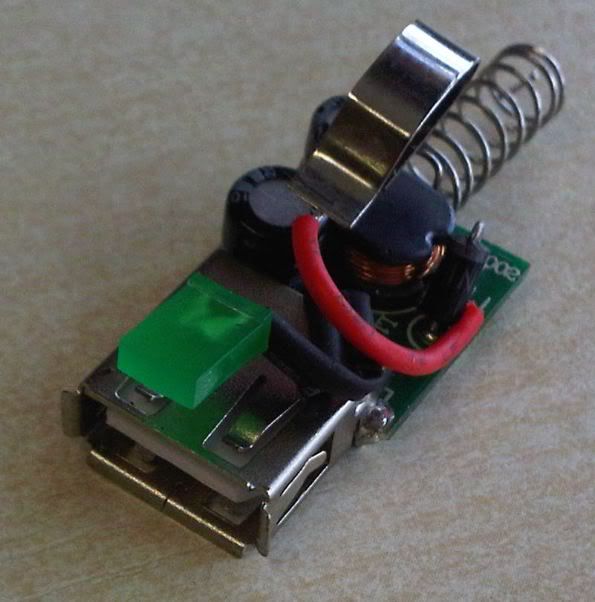

Right, i've pulled one apart. then guessing a case of cutting a hole in the dash, a bit of glue on the back, then wire up.
But, can I wire straight to loom? Does a 12v cigarette socket alter the power or is it just a form on connectivity?
