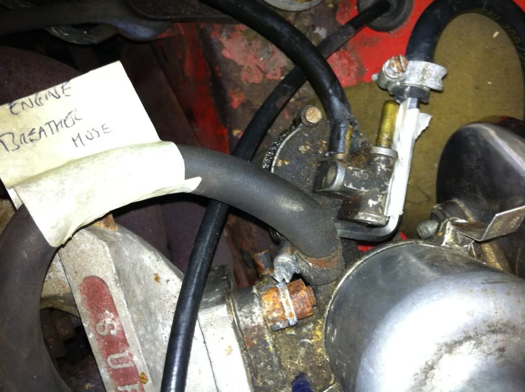

No 1 (bottom of pic - oil separator??) It's bolted to the back of the cylinder block and has a hose which is connected to the carb body - just under he dashpot (i've labelled it breather hose in the last pic)

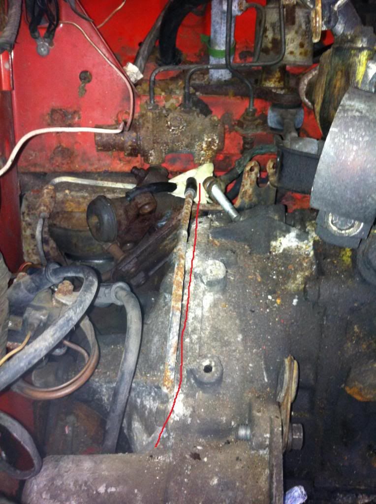

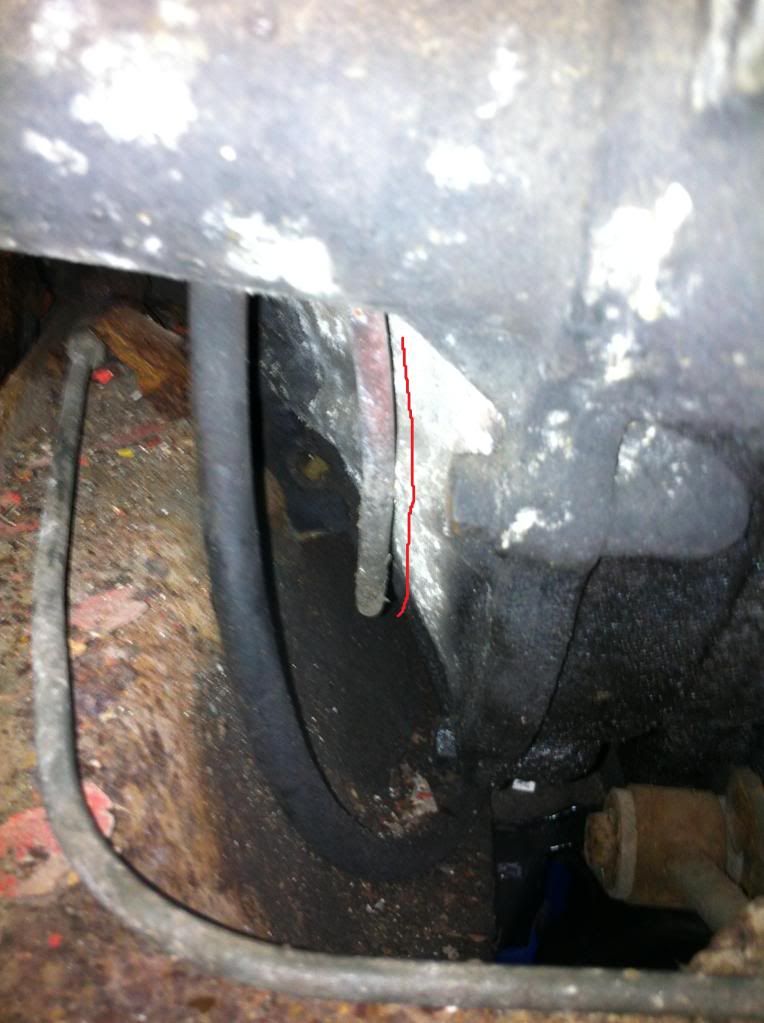

No 2 - its a steel pipe mounted to the cluch housing which has an open end nearest the bottom of the engine and is connected to a flexible hose near the clutch slave cylinder. The flexible hose is connected to the carb float chamber.

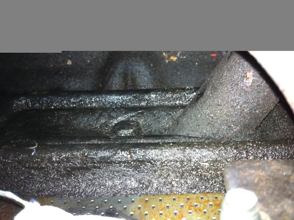

end connected to flexible hose:

Your first picture is of a breather, second one is the petrol over flow pipe,
Yep +1 on that :-D

cheers guys - what does the breather do?

Breather pipe goes to the carb were the toxic fumes from the engine are burnt away

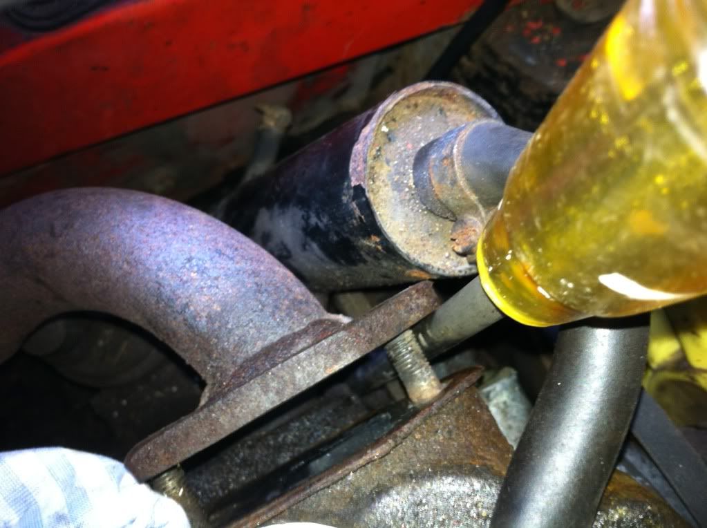

Thanks guys. The breather is getting in the way of me removing the exhaust manifold, as I can't get the manifold clear of the studs. Any ideas around this? Can I remove the breather? There is nothing obvious just 1 nut near it in the cylinder block - if I'm honest I don;t want to go unbolting random nuts on the cylinder block =]
nut near breather...

You can undo the bolt, there's a thick rubber gasket behind it. Keep it clean though: it's where the cam followers live.

I dont remember the oil separator being that close that i couldnt get the exhaust manifold off.
i did take the breather pipe off the top as mine has a hole in both ends (replacement pipe required i guess?) :wacko:
Once you have room the carb and the exhuast will come off together, having removed the clutch and accelerator cables.

If this car is on the road and just having maintenance, or you intend to get it on the road, it might be advised to have a good check over that front subframe, while you have a good dig round in the engine bay.
Your 3rd pic labelled "end connected to flexible hose:" has a very crusty looking subframe in the background (the bit with what looks like a large rubber doughnut). Always worth checking.

Managed to get the manifold free but had to loosen the breather a bit.

On one of mine, probably the 1976 model, the oil trap in the breather system fouled the manifold, so yours is not unusual. Usually when you loosen the tappet chest cover (there are two, one has the breather, the other is blank) the gasket remains stuck to the block, and can be re-used. Don't over-tighten the bolt when replacing it, or the cover will collapse.
